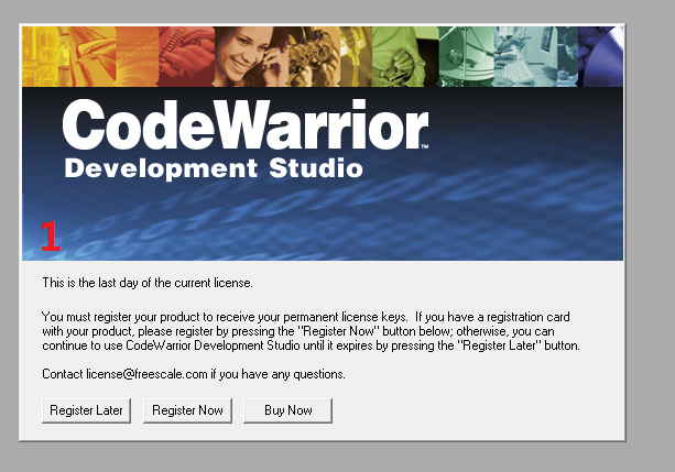

i just bought a codewarrior development suite(CWP_PRO_NL) with a USB dongle, but when i start the codewarrior IDE, a message appear to let me register (picture 1), and I have registered many times successfully, but the message always appears. i dont know why??

1、with the USB dongle, when start IDE a message appears as picture 1;

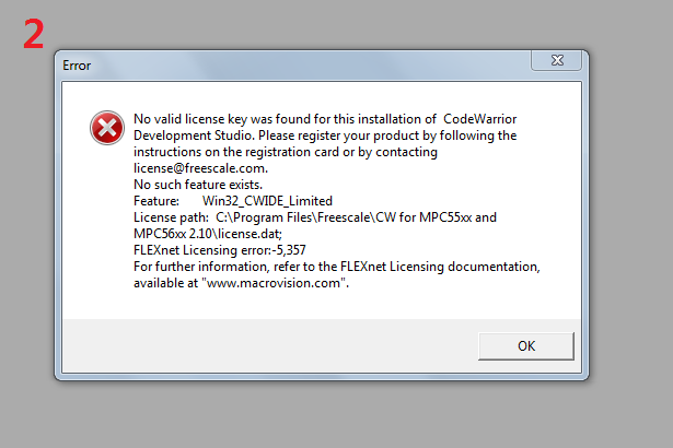

2、without the USB dongle, when start IDE a message appears as picture 2;

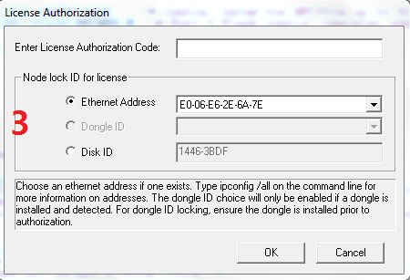

3、codewarrior - help - license authorization (picture 3) , the dongle id option can`t be choiced;

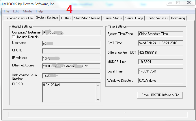

4、imtools can dectect the dongle ID;(picture 4)

6、the license file was generated from NXP website, and binded the USB dongle ID, then placed the license.dat to codewarrior install root folder.
I dont know which step have a problem, why the codewarrior require me register?   I have tried this in win7-32bit and winXP-32bit, but the problem is still there.

The message in first picutre is introduced by an issue between flexlm driver used on CW for MPC55xx and USBdongle.
Every time, every day you will launch the IDE you will get this message … but the license will work.
So don’t care about it.
You can remove this error message if you add the key:
FEATURE Win32_CWIDE_Limited metrowks 5.5 permanent uncounted \
00E825C5615A HOSTID=ANY TS_OK
Does it work?

       After added the additional key provided by you, the CW can be launched without USB dongle,   and the USB dongle has no use.  so I have some question :
1、does CW have a difference in use between  using USB dongle and no using USB dongle (added the additional key) ?
2、after added the additional key,  does the CW can be used on other PC at the same time?  ( i think it can ,because the new license is no USB dongle、net address、disk ID limit )

1- No. the additional key is just to avoid the message: "This is the last days ..."
     It doesn't have impact of CW excepted you can launch the IDE without the USBdongle plugged.
2- No. The Limited key is not locked on PC or USBDongle.
     By this way, without the USBDongle plugged you can launch the IDE but it will work under Limited restriction.
     Only the IDE will work but not other features as Debugger or compiler.

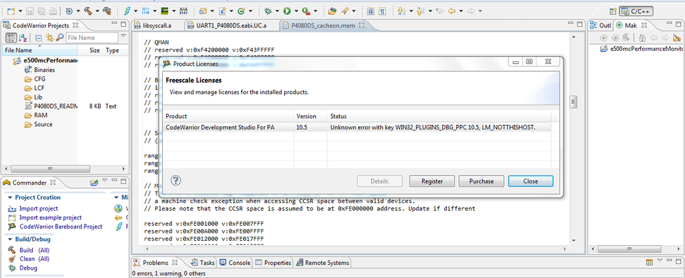

   I know you said, but I have another question, could the additional key apply to every software included in my codewarrior development suite?
I also installed the "codewarrior development studio for PA",it has the same issue message about register.   After added the additional key,it still appear the same message. It seems that the additional key is not useful for codewarrior development studio for PA.  There are many software in my codewarrior development suite, how can I reslove the issue for all software ?

CW for PA v10.x is using Eclipse IDE.
The license problem you could meet under Classic version are not the same of issue you could have with Eclipse versions.
Most of the time each issue is limited to a specific version.
The problem you could have with CW for HC12 v5.x and with CW for MCU V6.3 could be similar but the solution are most of the time different.
If you're using the USBDongle Key for the CW for PA v10.5 tool, I've posted a doc giving some hint for this issue.
Please have a look to:
    USBdongle license is not running for CW for PA V10.4 and MCU V10.4 (sometimes) -> "LM_NOTTHISHOST...
I've posted another doc giving some info about the USBdongle ...
    How to install/use USBdongle license under Win 8.1? (Include test with CW for MPC55xx V2.7 & CW ...
regard

The problem you meet is a known issue.
There is a compatibility driver between the USBDongle driver and some features of CodeWarrior as the IDE and Debugger.
The Picture 1 is normal but don't really impact the tool.
The message will appear every time/day you will launch the IDE.
To solve this issue you can add the additional key provided by Fiona.
Regarding the Picture 3 - License Authorization.
Don't use it. This is not valid anymore and was used in the past to register the product.
Now you just need to put the license file under your main installation folder.
Don't care about it.
