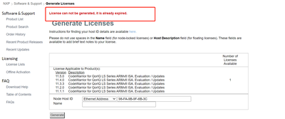

License can not be generated for armv8 ?

You have an evaluation license that expired on 9/21. You can try by extending the expiration date following these steps:
  1. Log in at www.nxp.com and go to My NXP.
  2. Click on ‘Software Licensing and Support”.
  3. Click on “Renew Expired Software”.
  4. Click the “Extend” button beside the appropriate evaluation software line item.
  5. Select the item title to extend.
  6. Read and Accept the Software Terms and Conditions.
  7. Click the “License Keys” tab.
  8. Select the license you need and click on Generate. NOTE: Click the "Return button" and refresh the page in case you see it.
  9. Click on Generate again.
  10. Click on Save all and use this license.dat file to replace the old one.
