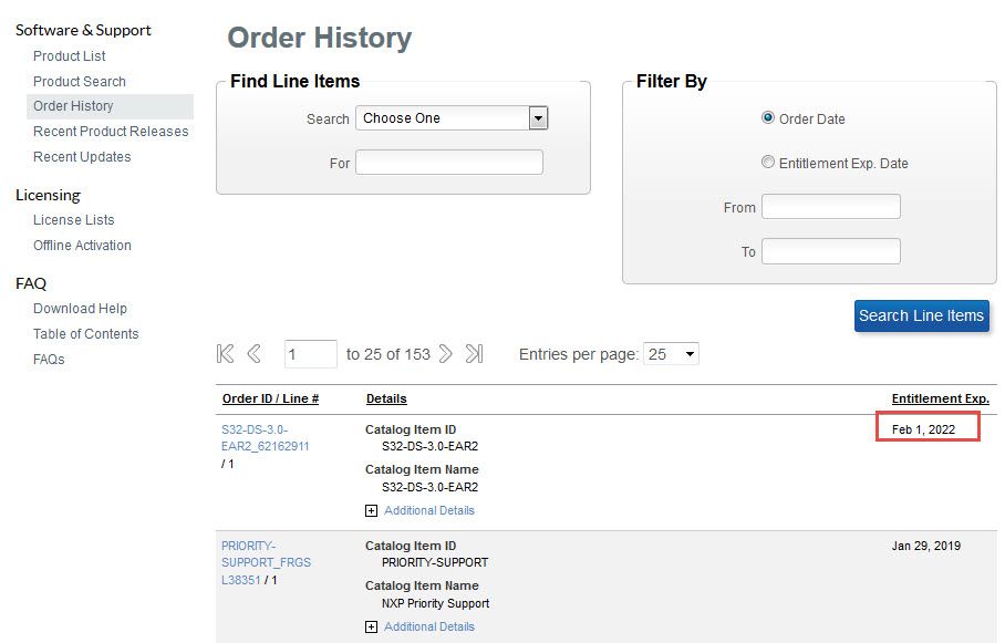

When I opened my codewarrior development studio,it showed the following message,
Detail information for product "CodeWarrior for MCU" version "11.0.0.FSL_b11001"
status: "License expired"
But in the webpage where I generated my license for codewarrior development studio, the license quantity showed the following message
License Quantity: 1Expiration Date: Jan 28, 2018
So when is my license actually expiring?

The expiration date of SW will defined by the date contained in the license.dat file.
You could have an end date of a previous period on the license and have properly renew your suite, in this case you will need to renew your license so you can use the license with the suite expiration date. Check following video
https://www.nxp.com/video/how-to-obtain-a-license-after-annual-subscription:GET-NEW-LICENSE-AFTER-RE...
check the license file and look for the license file expiration date
#### ( ???): DSC v8.3
INCREMENT Win32_CWIDE_Unlimited metrowks 5.5 30-jan-2018 uncounted \
                57DABF8D72CB VENDOR_STRING="CodeWarrior IDE 4.2 or later, \
                Windows" HOSTID=8c705a1 ck=171 TS_OK
In the web site, log to nxp.com site and go to sw licensing & support page, then move to order history there you will be able to see the expiration date of your suites and evals.
