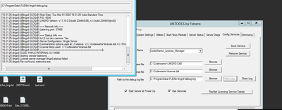

Hello Team,
Customer have generated license file and try to configure it on server but its showing error. PFB SS. Please help to resolve it.
Already software installed in PC. Could you please help me to answer customer. Kindly consider it as high priority.

It seems that the version of the License manager is not from NXP as the vendor deamon is not on the correct location.  Pelease have the user downalod teh Server License Manager from the link below:
