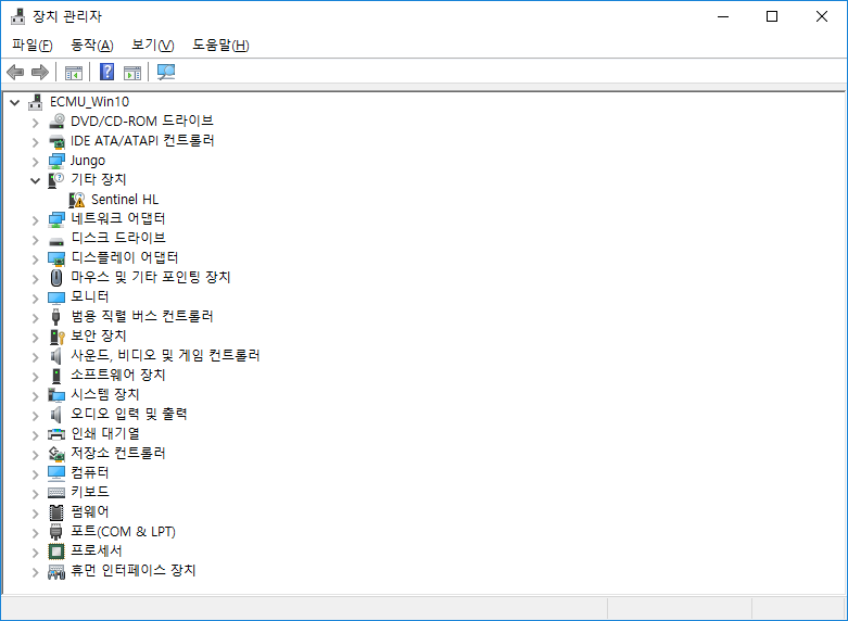

Hello.
I am trying to CodeWarrior USB License Dongle to my PC.
I am using Windows10 64bit, and installed Code Warrior Eclipse IDE for MPC5674F
I followed the guide of NXP to install USB dongle, but it may not recognized.

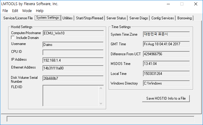

added with it, LMTOOLS can't find FLEXID code of the USB dongle.
I already uninstall and reinstall via 'FLEXid Clean Utility' but, the problem is not cleared yet.
Could you please give some advice to solve this issue?

Seems there is indeed a driver issue associated with USB Dongle + Windows 10 64-bit
I'd suggest to try to use the latest drivers available here:

I had same problem with fresh installs on different Windows 10 64-bit machines. It looks like Dongle is FLEXID 9 and I found this document:
http://www.cad-design.com/support/FLEXID9DriversforWindows10.pdf
I'm not sure it was necessary but I downloaded and ran their "FLEXidCleanUtility.exe".
Then found this website:
https://www.aldec.com/en/support/resources/documentation/articles/1245
Downloaded the "FLEXID9_Windows_v6_65_x64.zip" file. It looks like it provides the same files as the website with the clean utility but organized a bit simpler.
Copied the haspsrm_win64.dll file and ran "haspdinst.exe -i" as indicated.

Hi Stan. I am experiencing the same issues at Mac, and have tried installing the Sentinel drivers, and have seen no change.
Windows 10, 64 bit machine and attempting to view the FlexID in LMtools shows no code. Do you have any other suggestions?
