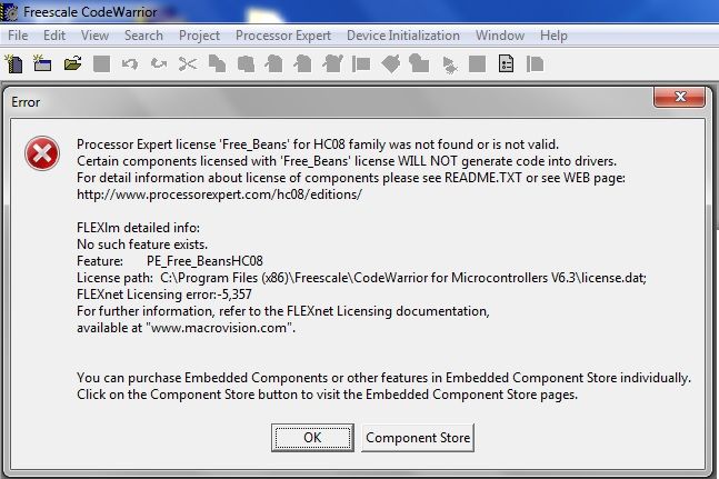

I bought a a CodeWarrior Licence for one year and some Processor Expert Libraries (*.PEupd) that I installed don't generate the code. I testes with 2 types of license, one in "FLEX ID" to use my dongle and another in "Disk Serial Number", the problem is the same. I use CodeWarrior 6.3.
See the first Error message at the start-up of CodeWarrior below:

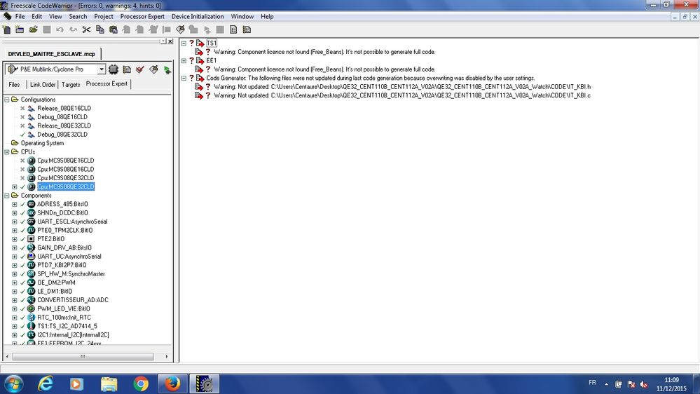

After this, I can use the installed libraries and CodeWarrior normaly but the code of the ocncerned libraries is not generated. *.c and *h files are generated with the name of the functions, etc....but no Code inside all functions (like the errror message below says). I used the same type of licence since 2 years without problem.  Can you help me please?  Thank you

trytohelp
Hi Sarah,
In some case the keys for Processor Expert could be corrupted.
It's probably the problem you meet.
By default the license file must be manually corrected.
The Case is the right process for this problem.
May be the license team is overloaded ...
If you need a temp license, please contact the support team.

trytohelp
Hi Brigitte,
In some case customer could meet problem with license file generated with web license system for classic version.
The IDE and PEx bean could be corrupted.
To solve it we need to correct the keys and re-encrypt the license file.
Don't think you want to share your license file on community.
I recommend to create a Case.
How to summit a Service Request online ?
To submit your case into the supporting system, please follow below steps:
1) Go to http://www.nxp.com/support/sales-and-support:SUPPORTHOME.
2) On the bottom of the page under Submit New Issues, click Hardware & Software.
3) Register with your business email to access NXP technical online support.
4) A verification email will be sent to your account. Click the link embedded in that email to verify your access.
5) On the NXP online support page, select Contact Support from the top menu and click “submit a new case” to start the process.
Please add the license file you're using.
Attached you will find a temp license.
Rename it to license.dat.
Pascal

samuelconti
Thank you, I will go to post on this support.
The Temp licence is OK.
