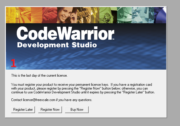

I just bought a codewarrior development suite(CWP_PRO_NL) with a USB dongle, but when i start the codewarrior IDE, a message appear to let me register (picture 1), and I have registered many times successfully, but the message always appears. I don`t know why?? the spec contents as follows:
1、Pluged the USB dongle, when start IDE a message appears as picture 1;
2、I have installed the USB dongle driver successfully, the LED light switch on.
3、the license file was generated from NXP website, and binded the USB dongle ID, then placed the license.dat to codewarrior install root folder.
I don`t know why the codewarrior require me register all the time?   I have tried this in win7-32bit and winXP-32bit, but the problem is still there. Thanks a lot !

Please close CodeWarrior, add the key at the top of your license, and restart CodeWarrior again.
INCREMENT Win32_CWIDE_Unlimited metrowks 5.500 permanent uncounted \
0CBFB52552B1 VENDOR_STRING="CodeWarrior IDE 4.2 or later, \
Windows" HOSTID=ANY TS_OK
Hope it helps! And this thread may be helpful to you.
https://community.freescale.com/thread/377864

I think you should use CW v5.1 or 5.2  for HCS12(x).
these versions support 64bit win7, but
"Please note: USB dongle license configuration not supported on 64-bit Windows 7®"
This is documented in CW5.x main page.
CodeWarrior Dev Tools for HCS12(X) MCUs|NXP
if you already have dongle license, I suggest you "rehost" it to node lock license. this is our recommendation.
How to rehost CodeWarrior suite license
Or use attached workaround (written by my colleague)
