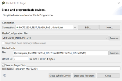

About how to program firmware to MCF52234 chip, there are two options:
1. Using P&E PROG-HL-CFZ software with P&E Multilink Universal debugger
P&E provides standalone Flash programming software for ColdFire chip, which works with WIN 10 system.
More detailed info, please refer below link:
 https://www.pemicro.com/products/product_viewDetails.cfm?product_id=15320181&productTab=1
2. Using CodeWarrior for MCU provided [Flash Programmer] tool with P&E Multilink Universal debugger tool:
Customer need to create a MCF52234 project, then call [Flash Programmer]  provided [Flash File to Target] tool.
The File can select customer would like programmed image.
Wish it helps.
