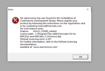

I am having a problem after installation. I purchased a node locked license for the CodeWarrior Suite and after installation I immediately get this error:
Note that I had originally installed the product on my D:\ drive and found out that it has to be installed on C:\. So I uninstalled and reinstalled on C:\ And now I get this error immediately and it will not let me continue.
Any suggestions?

Just to close out this topic, the issue was due to installing the product in the default location on Windows 10. I instead installed the product in C:\CodeWarriors and now everything works.
