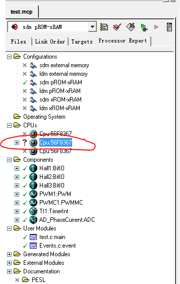

it failed by using the license with following error when opening old project:
after click OK button to go ahead, then you can see the system can not select correctly the chip CPU56F8367 with Question mark, see below:
i have no ideal how to do next, would you help me? Many thanks.

Hi Feng,
The license is not the same.
I've found there was an issue with the ProcessorExpert56800 feature.
If you check the license file you will see I've commented the original feature and added a new one:
# License for ANY
#INCREMENT ProcessorExpert56800 metrowks 1.00000 18-feb-2015 uncounted \
#    C4D7A6DBD5D1 VENDOR_STRING="CodeWarrior DS for Freescale \
#    56800/E Hybrid Controllers Standard Edition WIN EVAL" \
#    HOSTID=ANY ISSUER="Freescale Semiconductor" ISSUED=19-jan-2015 \
#    ck=89 SN="FSL - 12130701" TS_OK
    EC0884A04DA6 VENDOR_STRING="Basic \
    beans;B9940391A8E5D0A1E492A84D9E89C5B1;Advanced \
    beans;441AD243790CA097A4376051192F9D33;Free_Beans;AED213BBEC63CAA064A42992AB295838" \
    ck=103 SN="FSL - 12130701" TS_OK
Are you sure you're using the right license file ?
To check it you must:
          - rename all license file,
          - try to launch the IDE,
          - you should get an error with -1 error code ... refer to video attached,
          - valid the right license file.
Now it should work.
