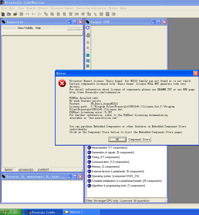

I have applied a eval license for codewarrior HCS12 5.1 professional version to develop program for S12XEP100 CAN module. I have replace the license.dat with the eval license, and renamed with license.dat. But when I try to create a program with PE, it says basic beans license is not found.
Here the license.dat and the error image are attached.

Please use my attached license file in above to replace your own license file.
I tested on my side, your license file also does not work with my CodeWarrior v5.1. However, my attached one works well. Could you please have a test?  Thank you very much!

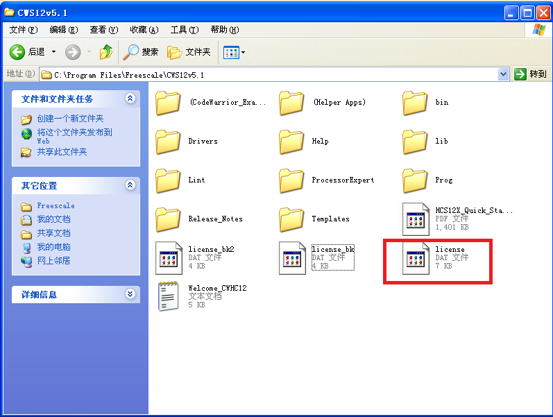

Please the license file in correct folder, it should be:
<CW path>\Freescale\CWS12 v5.1
!!!Please do not put it in 'License' subfolder.
Then please check the environment variable LM_LICENSE_FILE points to the right path of the license file.
The environment variable can be found by clicking on "start" menu of Windows ->settings->control panel->system ->Advanced ->environment variable
Please close CodeWarrior and run 'regservers.bat' which is under \bin subfolder in CW path.
<CW path>\Freescale\CWS12 v5.1\bin
Another tip is to check the system time of the OS. Whether it was set correctly?
Is the OS WinXP, or Win7? And is it a 32bit, or 64bit system?

luzhengchen
Thanks for your answer.
I am sure I put the license directly under the folder. And My system is windows xp sp3 32bit. Because I need use Softec to download S12XEP100 which only support windows 32bit. But the porblem is still there.
Here is the image attached.
