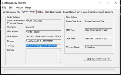

I'm having issues getting a dongle based node locked version of CodeWarrior V10.2 running on Windows 10.  I used the dongle latest drivers, and the dongle is recognized by windows.  However, running LMTOOLS per the pdf instructions results in the FLEXID not showing up.  I also noticed that the TPM_ID1 field shows "FNLS does not appear to be running".
Any help would be appreciated.

Hi Rick,
It seems that you are using an old Version of our LMTools and the Dongle dRivers have not been installed on the computer please find the new version below and also the instructions inside the Readme File inside the dongle Driver zip file.
Dongle Driver:
https://www.nxp.com/webapp/sps/download/license.jsp?colCode=CWX-FLEX-DD-STD
32bit:
https://www.nxp.com/lgfiles/licensing/LMTOOLS-32BIT.zip
64bit:
https://www.nxp.com/lgfiles/licensing/LMTOOLS-64BIT.zip
