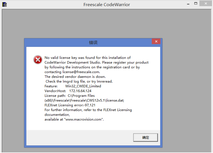

   My customer--Xiamen Shinlin bought CW license, they can't install sucessful the license according to "Floating License Installatio Guide for Windows", the Client can't work(see below picture), the attachments are FlexLM running picture and license file generated from Internet, the customer placed the license file in C:\FSL_FlexLM in Server, and placed it in \CW S12 V5.1 in Client. How can I install the license? Thanks.

The error code shows the vendor daemon is down
Error -97, The desired vendor daemon is down.
1) Check the lmadmin or lmgrd log file, or 2) Try lmreread.

   Could you help on that? The problem still is not solved, below is license file data. Thanks.
