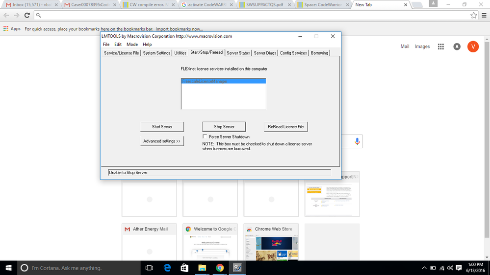

1)   Can you Explain me, what do you mean by creating a new service on lmtools.exe???
I tried re-reading and  stoping the server for both of them Failed, I have attached the Screenshot of them.

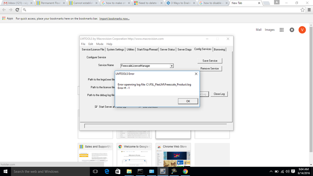

I am not able to open the Log File.It is also Failing.

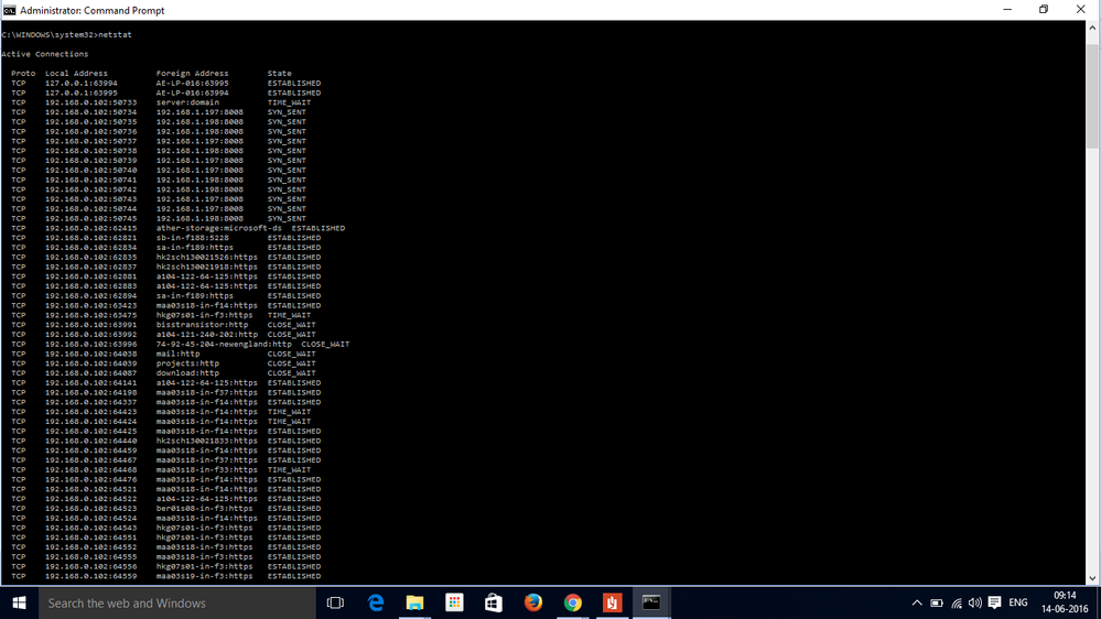

2)How to check whether TCP/IP ports from range 27000-27009 are Free?
I tried Checking The port was busy with other things by using netstat command from the command prompt.I have attached the Screenshot of it also.
