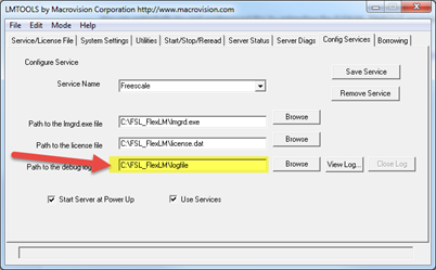

    We bought a CodeWarrior Floating License.But It is not working.We followed the Documentation provided by freescale but still it is not able to connect to the server.
I have attached the Documentation and Screenshhot of Server Stattus and Server Diagnostics in the .zip file.
I am not able to connect to the server.I am actually using the same Machine as Server and Client.Eventhough I have tried pinging the server and I got a response for it.

It will be good to see the log file located in LMTools.exe utility , check the log file on the path specified
If you are using multiple clients, sometime check in does not occur right away this might be a root cause.
Share the license server heather

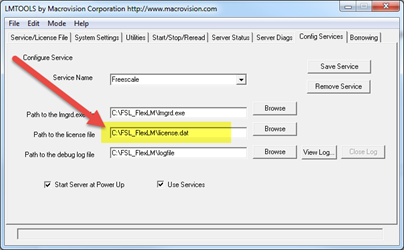

Review if you have added the license file on both side, the application for example
On C:\Freescale\CW MCU v10.6\MCU
And also on the location specified on the license manager

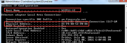

If you are using the same station as client and server, make sure you use the correct client name and the Ethernet MAC address or Disk Serial
I expect to see something similar on your license.dat
SERVER b33911-12 ECF4BB52F0AA
VENDOR metrowks
USE_SERVER
