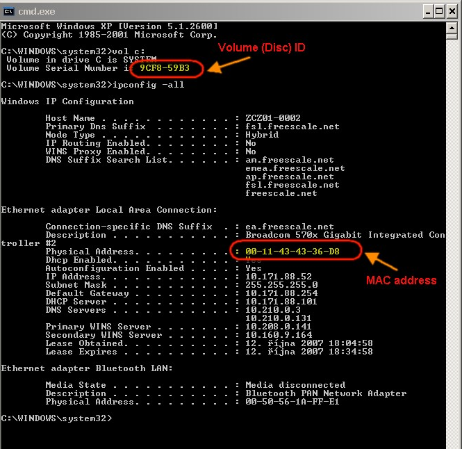

mani8421
we had a license working for the Code warrior for MPC860 Processor on PC, Due to some problem we had to change the motherboard of the PC. After changing we are not we are getting the license error
Error   : Unable to use the plugin "MW C/C++ PPC EABI". It is licensed and a valid license key was not found.
Invalid host
 The hostid of this system does not match the hostid
 specified in the license file
Feature:       Win32_Plugins_Comp_PPC
Hostid:        00e04c4d0e3a
License path:  C:\Program Files\Metrowerks\CodeWarrior PowerPC Comm -
    V8.5\license.dat
FLEXlm error:  -9,57
For further information, refer to the FLEXlm End User Manual,
available at "www.macrovision.com".

stanish
Let us apologize about the delay...
This error probably occurs due to the fact your lock ID (which is MAC address of your network card) has changed and it does not match with the original license.dat anymore. You can check your new MAC address e.g. in Windows Terminal:
You should rehost the license either using your nxp.com account:
please see this video: How to move your license to a new computer|NXP
Or submit a licensing service ticket: https://community.nxp.com/docs/DOC-329745
Hope it helps.
Stan
