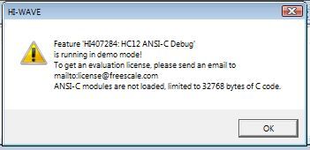

i have the CodeWarrior 5.2 tool setup for HC12 micro-controler.
The license we have bought is based on a Dongle ID.
The product has been registered, the corresponding license.dat file is generated and placed in the tool's installation directory.
1 - the codewarrior IDE opens properly, which means it can access the dongle and the license file is correct (in my point of view)
2 - the project is compiled to the end, there is no error, the code size is about 67KB
3 - after the binary has been generated, the debugger is called, the binary is flashed into the target
4 - at the end of the binary download, a error dialog box pops up:
In the log file of the debugger, it is mentionned that "The hostid of this system does not match the hostid specified in the license file"
The flexID i have used to register the product is the one displayed in the lmtools.exe
Could you tell me what i need to do to be able to use the CW debugger ?
Thanks in advance,
Michel

HI407284 (metrowks, 5.000): HC12 ANSI-C Debug (HC12, checkout failed, demo mode: 1024 bytes of code, running in demo mode(-9), UNREGISTERED)
Invalid host
Feature:       HI407284
Hostid:        FLEXID=9-75744CE5
License path:  C:\Program Files (x86)\Freescale\CWS12v5.2\license.dat
FLEXlm error:  -9,57

Hi Michel,
I think it's could be the same problem we've with HC12 v5.1.
To Resume:
Before the new driver was introduced (so before June 2011), the USBdongle worked on XP 32 bit only.
Now the new driver support all 32/64 bit OS so Win 7 too.
Unfortunately the USBdongle is not working for HC12 V5.1 under Windows 7.
I performed some tests on my side and I was not able to launch the debugger with an USBdongle.
The problem is linked to the Flexlm version used by the debugger to manage the license.
The new driver is working for Windows 7.
If you install it, the USBdongle will work for the build tool chain only.
So you could use it to build your application.
However the debugger is not compatible with this new driver - the debugger license can not be checked on the USBdongle.
Why ?
Products built with 8.4a of Flexlm (i.e. All of the classic products) will not be able to support win 7 64-bit with USB dongle licensing.
That support was added in 11.4 of Flexlm and our eclipse products moved to 11.5.
To resume, CW for HC12 V5.1 can be used on Windows 7 but not with USBdongle.
To avoid problem we recommend to rehost the license file to the DISK/HOST ID.
