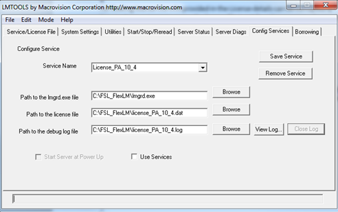

On the server, the log file captures all accesses done to the service
If there is an issue, the problem will be captured in the log file.
The log file contains lot of information to understand what is the problem (If there is one).
To generate this file, on the server, launch lmtools and select Config Services tab.
Inside "Path to the debug log file" field define a file as - for instance CW for PA v10.4:
If the C:\FSL_FlexLM\license_PA_10_4.log is already generated, I recommend you to:
- stop the service,
- delete the log file via explorer,
- re-start the service,
- reproduce the problem on client,
- try with an example project requiring a license file,
- stop the service.
Open the log file to check how the floating license file is used.

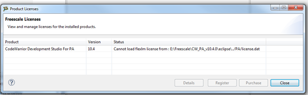

Specific trouble for CW for PA V10.4 & CW for MCU V10.6
Under PA V10.4 for instance when the port@host environment variable is used and the service is running on server, when we launch Eclipse we get a wrong license information:
According to the message the license file is not found.
For MCU V10.6, the Help + Freescale Licenses menu is not available.
PA v10.4 and MCU V10.6 using port@host protocol gives you the same message than if no license file was used/defined.
It seems the Product is not detect when the LM_LICENSE_FILE Environment variable is using port@host.
Most of the time the license file is running fine.
Is there a way to check it ?
                ……….. YES, generate the log file as explained above.
