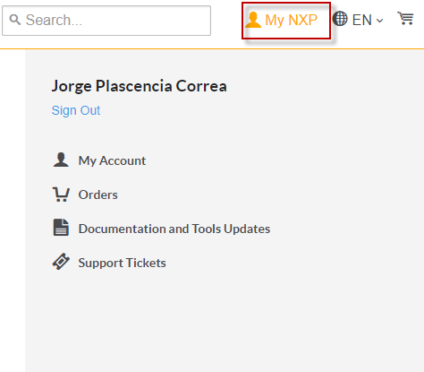

  1. login to www.nxp.com
  2. Click on My NXP from the top right menu

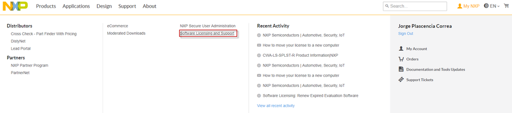

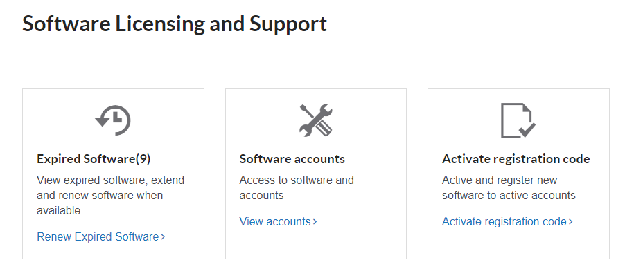

  3. Click on the link called Software Licensing and Support

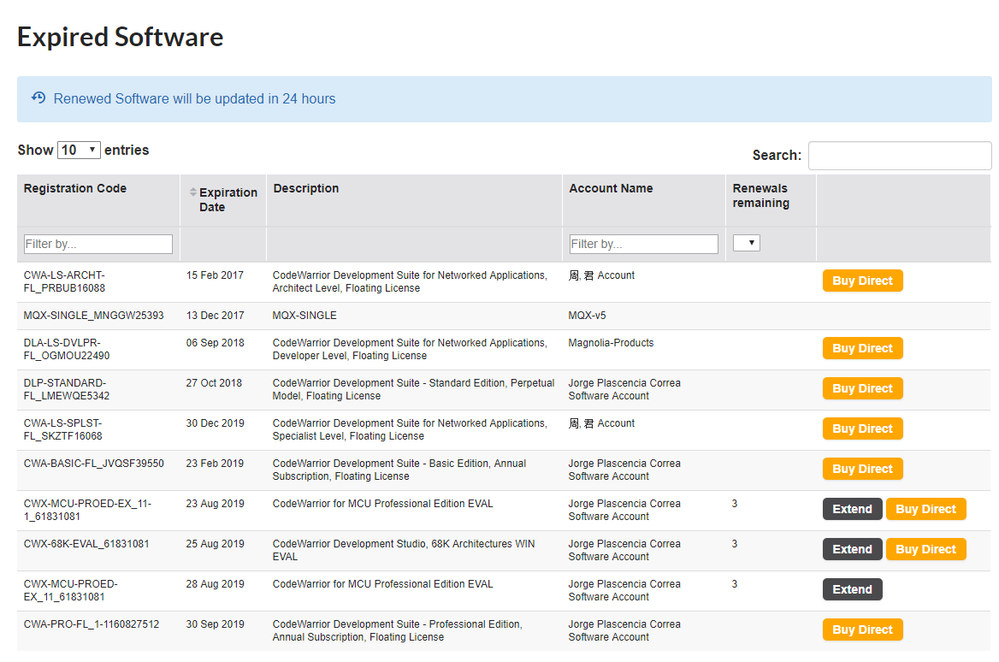

  4. Click on Renew Expired Software
  5. Click on the Extend button of the software you like to Extend.

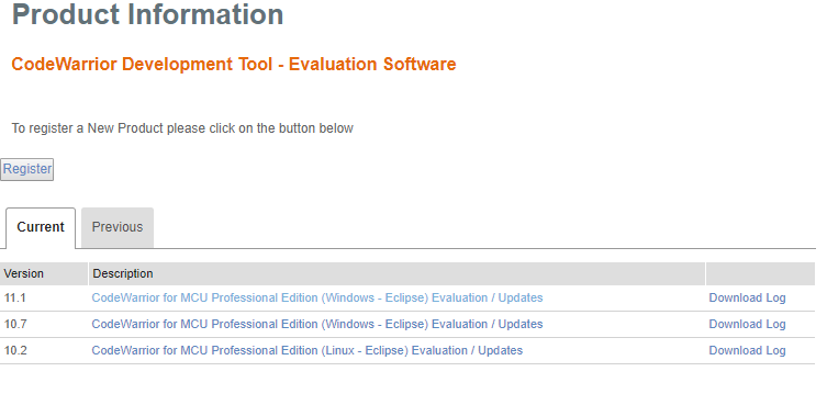

  6. Select the Product that you like to generate the new license for

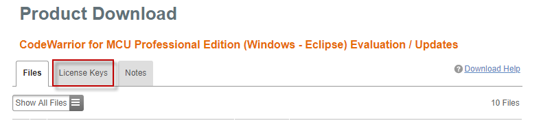

  8. Click on the License Keys Tab
