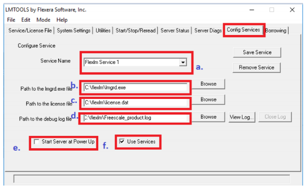

3. Open LM Tools / Go to Config Services tab pastedImage_13.png
  1. Service Name: Please type a new service name.
  2. Service Name: Please type a new service name.
  3. Path to the license: select the location of the license file.
  4. Path to log file: create a file to save the log file from server.
  5. Uncheck Start Server at power-up.
  6. Check Use Service.

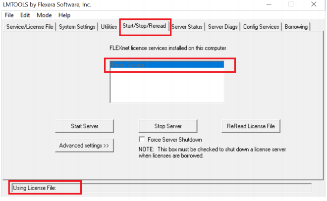

4. Open Start/Stop/Reread tab
  • Select the new created service and click on reread License file.
  • Check on the license status on the low left side of the windows. License read successfully is expected.pastedImage_19.png

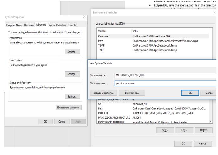

  • Go to System within control panel.
  • Click on advanced system settings.
  • Go to Environment Variables.
  • Look for METROWKS_LICENSE_FILE – if there is no variable please click on add.
  • Assign value to for client
  • Classic CodeWarrior IDE, save the license.dat file in the directory where you installed the software (usually C:\Program Files\NXP\Code Warrior for XYZ\).
  • Close and test
