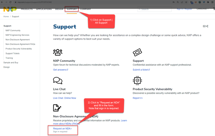

9,129件の閲覧回数
makinako
Hi yes I have an active NDA and have the JCOP 4.5 tools which contain JCShell, etc. As I described in my post there is a JCShell user manual, but this has no definition of the usage of DEFUN and no separate example scripts.
I am unable to find anything beyond this in the Secure Files and in my experience, it is not easy to know what documentation may exist that I do not have access to as there is no listing of available documents until you specifically have them pushed to your account.
Are you able to provide doc #'s or other references and can you push documents to an existing account with product access, or does this need to go through our account manager?
