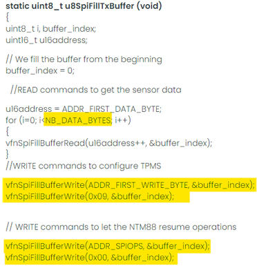

I am using NTM88 for BLE based TPMS application, where i am using CC2340R5 for data transmission on BLE. I am able to read the sensor data from NTM88 using SPI but i am not able to write the data in NTM88. i want to send some values in order to set the threshold for pressure and temperature values. but whenever i try to debug the issue by putting it into debug mode the connection gets terminated from NTM88 side. i am reading the sensor data from 0xcf location and trying to write the threshold value to 0x0091 location. i have followed NTM88_GenFSK_Beacons examples.

static uint8_t u8SpiFillTxBuffer (void)
uint8_t i, buffer_index;
uint16_t u16address;
// We fill the buffer from the beginning
buffer_index = 0;
  //READ commands to get the sensor data
u16address = ADDR_FIRST_DATA_BYTE;
for (i=0; i<NB_DATA_BYTES; i++)
vfnSpiFillBufferRead(u16address++, &buffer_index);
//WRITE commands to configure TPMS
vfnSpiFillBufferWrite(ADDR_FIRST_WRITE_BYTE, &buffer_index);
vfnSpiFillBufferWrite(0x09, &buffer_index);
// WRITE commands to let the NTM88 resume operations
vfnSpiFillBufferWrite(ADDR_SPIOPS, &buffer_index);
vfnSpiFillBufferWrite(0x00, &buffer_index);
// Note that it would be necessary to perform an additional transfer to read the WRITE command status
return buffer_index;

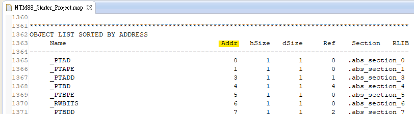

Hello Ankit,
In any project, the address allocated to each object (including variables) can be seen in the map file generated during build and located in the FLASH folder of the project.
The map file has a section named “Object list sorted by address”, which lists all objects sorted by increasing address:
So I would recommend to open that map file, and look which variable is allocated at address 0x91.
0x91 is a valid RAM address, part of the RAM section which is not maintained in STOP1. The map file will allow to check which variable is stored at this address.
Regarding the SPI sequence, we recommend using a logic analyzer to check the entire SPI sequence. If the sequence is as expected, then it means the issue is not with the SPI.

In the function below I see that transaction.count is set to value 10. I am not familiar with these drivers, but I would assume that this represents the number of 16-bit transfers to perform.
If so, there are 12 transfers (not 10) to perform according to the function below.
A READ command is sent via one transfer, and a WRITE command via two transfers. In below function, there are 8 READ commands and two WRITE commands, which makes a total of 8 + 2*2 = 12 transfers.
=> So I would try setting transaction.count to value 12.

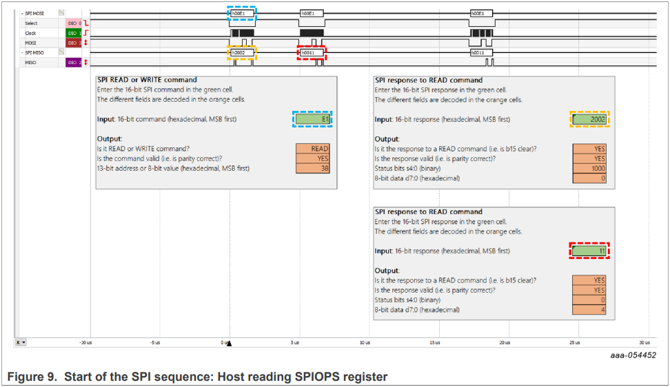

And after that, I would recommend monitoring the SPI transactions with a logic analyzer to check the number of content of the SPI transfers. This is good practice to ensure the communication is performing as expected, and to debug communication issues. See below an example of logic analyzer screenshot taken from the application note AN14182, Implementing Wired Communication with the NTM88, showing the detail of the SPI transfers. See section 2 of the app note for detailed information on the hardware SPI block of the NTM88.
The SPI commands and responses are decoded using the SPI encoding and decoding excel file provided with the application note.

transaction.count=10 in the code below is number of 16-bit transfers, and i am reading 6 bytes and writing 2 bytes so 6+2*2=10. NB_DATA_BYTES is the no. of bytes that BLE IC will read and i have set it to 6. So by the above logic 10 counts is correct number of 16-bit transfers. i have a doubt about the write address location on which BLE IC is trying to write using SPI write operation i.e. 0x0091, is this location correct or am i using incorrect location or sequence?
