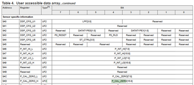

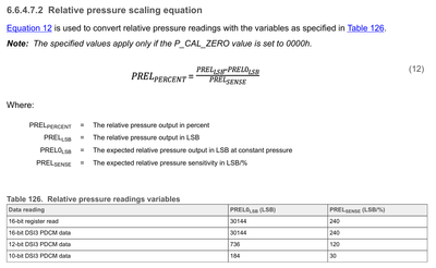

Hi!
I am using FXPS71407! I configure data type to 0x0 which means relative pressure data. And then I read snsdata0, it is 0x0. But as the datasheet showes below: the board is in a constant pressure, the data in 16bit register need to be 0x75C0, but it is 0x0. Is there something wrong?
Thanks!

Hi gangli_weride
The P_CAL_ZERO register is UF2, if the UF2 is locked, that might cause you problems in saving the values, check if the UF2 is locked or not.
Have a great day and best of luck.

gangli_hhh
The UF2 was not locked. The register 0x5f value is 0x00
