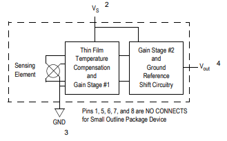

Hi Roshan,
Yes, it should be easy to connect this sensor to Arduino boards.
It is a 5V, temperature compensated and calibrated differential pressure sensor for ±25kPa. The offset is 2.5V and the output is 90mV per kPa.
The pins are numbered as follows:
So connect Arduino 5V to sensor pin 2. Arduino GND to sensor pin 3. Arduino analog input (for example A0) to sensor pin 4.

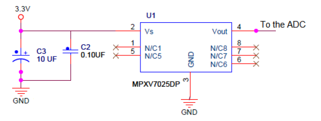

Hi tomas,
 I am usinng following circuit. what is the range of ideal ADC
values from pressure sensor.

Hi Roshan,
First off, the operating supply voltage is from 4.75V to 5.25V. 3.3V is out of the recommended range.
With no pressure applied (no pressure difference between P1 and P2), the output voltage should be around 2.5V. Then try to force some air into P1, e.g. using your mouth and see if the voltage goes up.
