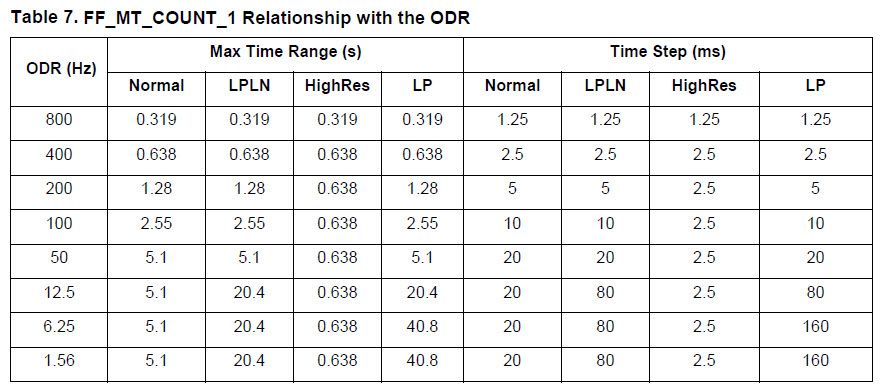

The MMA845x contains an embedded transient function which analyzes the high-pass filtered data allowing the user to set a preset threshold with an added debounce counter to ensure the event happens for a set duration. Please review the figure below:
In this case, the EA bit from the FF_MT_SRC register, indicates a motion event after debouncing. Once the debounce counter reaches the threshold, the EA bit is set, and remains set until the FF_MT_SRC register is read. When the FF_MT_SRC register is read, all register bits are cleared and the debounce counter are cleared and a new event can only be generated after the delay specified by FF_MT_CNT.
Please note that the time step used for the debounce sample count depends on the ODR chosen.
I recommend setting a fixed ODR and then, set the debounce counter to eliminate false readings.
Example:
Set the debounce counter to eliminate false readings for 100 Hz sample rate with a requirement of 100 ms timer.
Note: 100 ms/10 ms (steps) = 10 counts
IIC_RegWrite(0x18, 0x0A);
I hope this information will be useful for you.

I've read up on debounce on Google, but am having a slightly difficult time understanding it in the context of this sensor (other resources talk about switches, for example...)
To my understanding, debounce counter means that an event (in this case, the movement/impact/shake that triggers the transient interrupt) must happen for a specified period of time (say 100ms) before the chip picks this up as a true event, rather than noise. Would I be correct in this assumption?
If I am, is there any information relating to this in terms of timings, and the physics behind them?
For example (the numbers are probably wrong), if I drop the device, it hits the ground, at which point:
at t = 0: has impacted on the floor, and vertical velocity becomes 0.
at t = 10ms, acceleration begins to be experienced upwards due to force exerted back from the ground.
at t = 50 ms, device accelerates up, and vertical velocity also.
So if this were the case, I'd set the debounce to e.g. 50ms - since I'm at 100hz, then that'd be 5 steps.
Is this correct?

Indeed, you assumption is correct.
Please note that the debounce counter acts like a filter to determine whether the condition exists for configurable set of time.
As I mentioned before, I recommend setting a fixed ODR and then, set the debounce counter to eliminate false readings.
