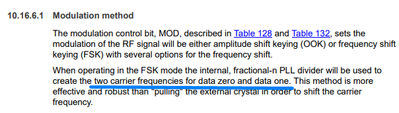

Greetings to the community! In the manual and datasheet we have information that the NTM88 has FSK modulation, however it does not specify whether it is type 2-FSK or 4-FSK, in this case, would it be type 2-FSK?
I thank the help of all!

Hi Israel,
please refer to the section 10.16.6.1 in the UM11227 attached. The FSK is 2-FSK type.
