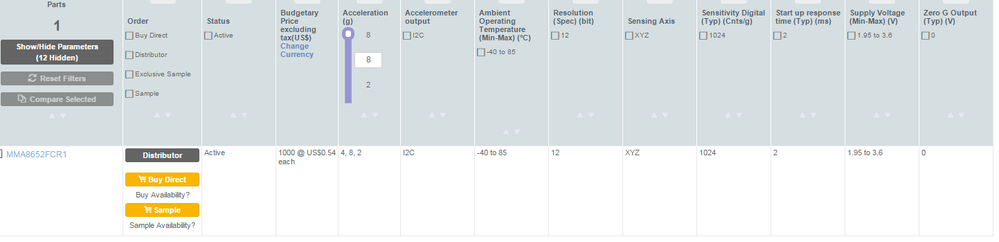

Thanks for the reply! Yes i have already saw that price and ordered the mma8491q :smileyhappy: We want to inspect the garbage vans discharging of garbage containers. So actually a 45degree tilt detection is enough for us. We want to ignore the horizontal movement of the container(because normal people can push or pull the container too). It must just wake up when the container has been picked up by the garbage van,so the accelerometer must wake up with this movement and then needs to waken the host mcu, and then mcu implements its own processes. We want to use low power components as much as we can. I'm gonna think over the MMA8652FC, i can use it with the auto wake-up mode if we conclude that current consumption is enough for us.

I suggest you to use the MMA8652FC accelerometer instead of the MMA8491Q. To use sensor sample rate you're looking for a function we called DATA_READY interrupt. The sensor pulls-up (/pulls down) a pin to wake the mcu when a measurement occurs.
For your application the best thing is to use the motion detection feature includes in the MMA8652FC .
The option is also using an interrupt pin to wake-up your mcu. You can configure thresholds thought I2C.

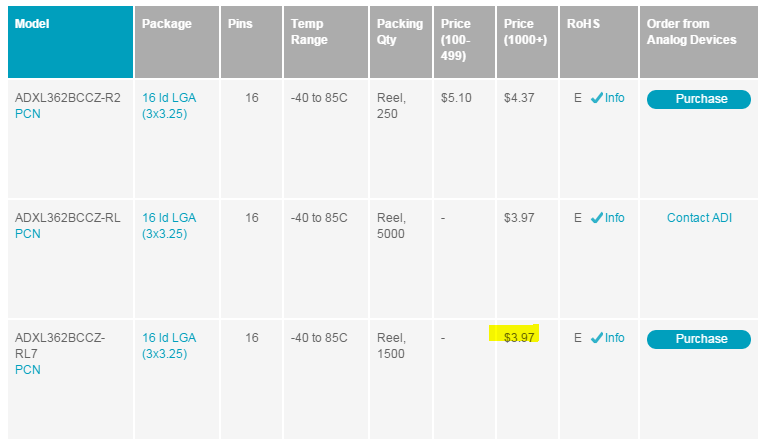

I have found an accelerometer with motion activated wake up mode, 270nA current consumption. I don't know it is ethical to share the model number in here because it is not freescale's accelerometer. It's ADXL362 from analog devices. I have already ordered a breakout board for Freescale's MMA8491q but i realized i need wake-up mode. Is there any Freescale's accelerometer with wake-up mode and low current consumption like lower than 1microamps? MMA8652FC has 6.5 microAmps for ODR = 1.563 Hz.

I'm sorry for that, but for the moment we don't have any ultra low-power accelerometer in our portfolio​. We will have a new one, but it is not on the market today.
ADXL362 is a pretty utlra low power device, that true, but look at the price....
... it is 7 times more expensive than ours.
