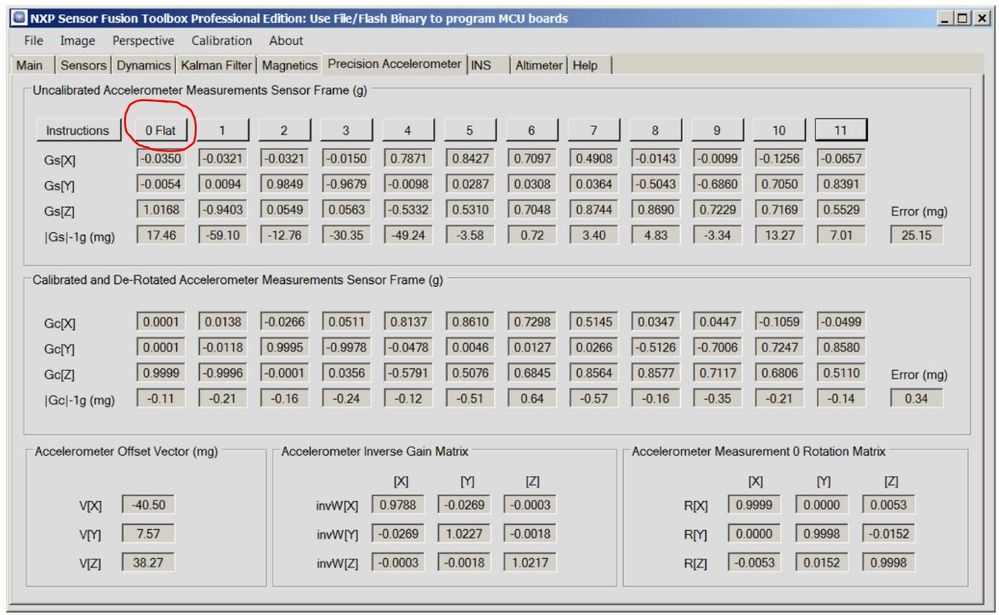

The tilt correction matrix is a rotation matrix to align the pitch and roll angles to the perpendicular plane of gravity so it can be considered as a change of basis or alignment matrix if, for example, the sensor frame is not aligned with the body frame.
I haven't been able to find in the sensor fusion documentation "when" and "where" in the filter this rotation matrix is computed. Does anybody have the answer?

I'm referring to the "0 flat" button in the "Precision Accelerometer" tab. The funtion of this button is described in section 4 of document AN5021 (Accelrometer tilt orientation matrix). When pressing this button, a tilt correction matrix is stored in memory and applied to orientation data. I would like to know when is this tilt correction matrix applied in the filter.

Precision Accelerometer Calibration compensates for mounting offsets - correction of offsets due to Plane of Sensor not being aligned to gravitational plane, for details you may refer to chapter 7 in AN4399 available @ NXP - High-Precision Calibration of a Three-Axis Accelerometer.
In the SF Application, the sequence of steps involved to apply Precision Accelerometer Calibration to Accelerometer Measurements is as follows:
  • First, using the Precision Accelerometer tab, 12 point accelerometer data measurements can be carried out and used to compute Calibration parameters.
  • Then, using options form Menu item Calibration, the computed calibration parameters can be written to the MCU board Flash.
  • Subsequently, from the next board reset, the written parameters are read and used by the SF Application.
  • The Calibration parameters are applied to every new accelerometer measurements after it is acquired. This is done inside the processAccelData() function in sensor_fusion.c file in the SF code.
  • The resulting measurement is then used in all Filter Algorithms by the SF Application.
