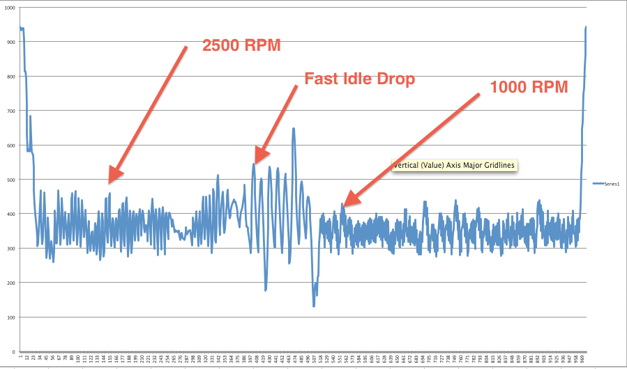

Hey Josh - I also have an old Honda!   It's a 1976 CB360T and is in mint condition.    A couple of updates:
1. I misspoke - 30mmg is 4kPA and .5 PSI - I used the wrong unit of measure.  :smileyblush:
2. Had some time this afternoon to put my breadboard on the bike. Fun!  Hooking up only one cyclinder, it's averaging about 30.66 kPa or 4.45PSI between 1k and 2.5K rpms.   The R1150R is fuel injected but BMW does still have a procedure for balancing the throttles by measuring air intake.   Fortunately, the same piece of tubing used to connect the sensors works on my bike - no adapters. You were right about total vacuum draw on the bike.
3. I used a running average of 10 samples taken at 1 millisecond intervals to generate the data.   As you can see in the chart below, numbers are hovering between 300 and 400 for the most part.  The chart's leftside was at 2500RPM and then lowered on the right to 1000RPM.  The value 'flopping' in the middle was me dropping the fast idle switch on the bike.
I'd like to get it smoother - maybe it's the bike?   Can you tell me if it's worth doing more than 10 samples for a running average?  How many should I consider?
Also, would it be worthwhile to use a resistor and different cap as this paper recommends?  Makuna didn't use it.
4. I'm still tempted to try a single differential sensor MPXV7025 if there's a way to determine if the sensor can tolerate +100kPa difference in either the P1 or P2 direction.   Is there a way to obtain a sample from FreeScale?
Tomorrow if my wife lets me, I'll solder up the right cylinder sensor and test both sides - perhaps even measure the delta.  TIA - Pascal

Joshevelle
Senior Contributor I
Hello Pascal,
Old vintage bikes are awesome and bullet proof!. I bought mine from a junk yard, ready to be  destroyed, it took me one year and TONS of wife's argues, but now is ready to ride again :smileycool:.
I would recommend you to use a low pass filter as shown in AN1646, ten averaged samples after filtering should be enough to get rid of that noisy signal. I'd recommend you to use the resistor and capacitor shown in that document too.
The MPXV7025 is a bidirectional pressure sensor, which means that you can apply either pressure or vacuum to both ports. However the sensor will measure the differential pressure between P1 and P2 and it can support up to 200kPa. The differential pressure that you'd measure from one intake manifold to another would tend to zero since both pressures should be equal.
