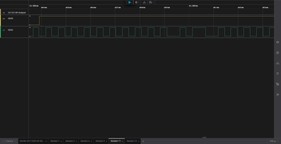

I'm trying to match an OEM TPMS sensors bit timing using a FXTH87E sensor.  I modified the getting started project, FXTH87_E_FW_Periodic_RF_Tx.
The issue I'm seeing, I'm trying to achieve ~25us bit timing for the data being sent but I have bits that are ~50us and others that are ~25us.  I have tried doubling the Data Rate via RFCR0 to ~40 kbits which fixed the preamble but then I end up with bits that are ~13us.  I'm using Manchester encoding as well.
I can't seem to figure out the correct settings to have the bits all at the same data rate.  I have attached my main.c as well as two logic analyzer captures, one of the OEM TPMS sensor and mine.  I'm trying to duplicate a packet length of ~5ms and bit timing of ~25us.  I'm currently getting a packet length of ~7ms and a variable bit timing of ~50us and ~25us.
Any suggestions would be greatly appreciated.

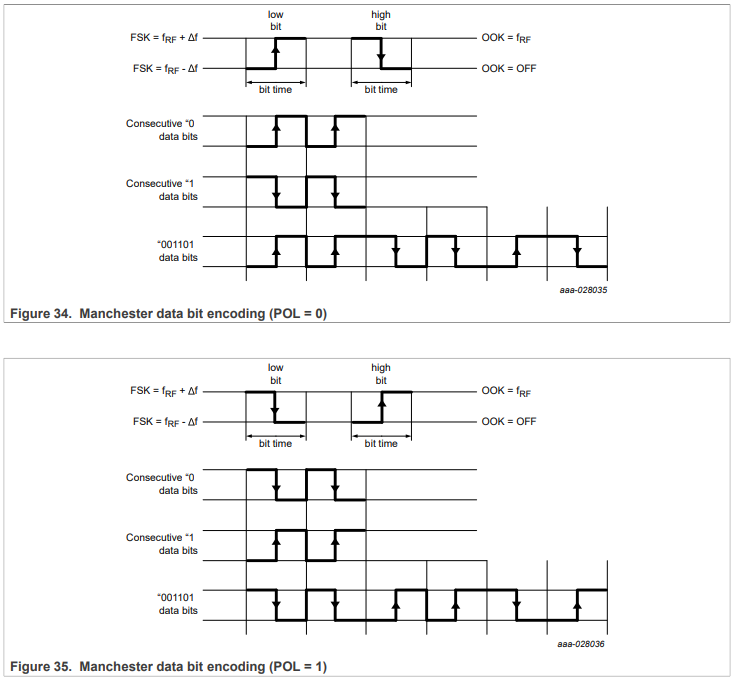

Hello Craig,
From the code in the main, 136 bits are transmitted at a data rate of 19200 bps (RFCR0 configuration). This makes a transmission time of 136/19200 = 7 ms. So from the code, it is completely expected to have a frame lasting 7 ms and not 5 ms.
With a data rate of 19200 bps, one bit lasts ~50 us. From the RF configuration, Manchester encoding is selected at 434 MHz. And in Manchester, there is a high-to-low or low-to-high transition at the middle of the bit (so after ~25 us). It means that a low or high state can last either 25 us or 50 us.
I copied below the extract from the manual (UM11227) showing Manchester encoding.
So the waveform captured matches the configuration done in the main.c, there is nothing unusual.
BRs, Tomas

Thank you for your detailed response.  The OEM sensor, that is also using an FXTH87E, must not be using a standard way of sending the data?  The logic analyzer capture below doesn't have transitions like what is displayed in UM11227.  As far as I can tell, consecutive 0's and 1's aren't creating a transition, it just holds the same value for two cycles i.e. ~50us.  The decoded capture is:
010101010101010101010010110010101010101
Is it possible they are somehow modifying the data being sent to create the above data with consecutive bits doubling the bit timing without a transition?  I have tried using the different CODE[1:0] settings and I've also increased the bit timing to 40 kbit to get the ~25us bit timing but it did not remove the transitions.  I apologize for the simple questions; this is my first attempt at trying to duplicate a packet of data.  Any further guidance would be greatly appreciated.
