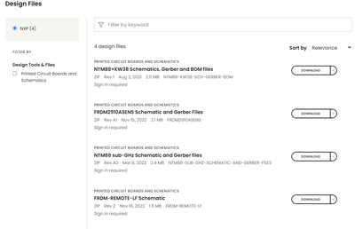

Rahul_KV
Please share the layout guidelines for the NTM88Hxx5S [NTM88H135ST1] chipset as we couldn't find anything in the DS.
1,571件の閲覧回数
JozefKozon
Hello Rahul,
for the PCB guideline please refer to the AN1902. Mainly to the section 5. onward. Further you can refer to the EVBs Design Files on the NTM88 product page. You can take the Evaluation Boards as reference for your design.
