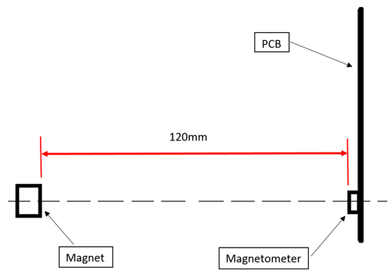

lukelynch
This image will give you an idea of my set-up.
5,915件の閲覧回数
lukelynch
Hello again Tomas,
I set up the interrupt as latching and when it goes low i read the M_THS_SRC register to check if it was positive or negative polarity. I wanted to do this to eliminate an interrupt if someone stuck a magnet against the back of the PCB (-Z-axis) the FXOS8700CQ is mounted on to stop false detections. From testing i see its not the positive or negative of the z-axis but the polarity of the magnet? would that be correct?
Would any off the other functions allow me to detect a magnet force within lets say 200 counts of x/y/z coordinate(in counts, example: 500,500,1100)
Or can you think of another way? or by software etc?
Basically i dont want it to give out an interrupt if some was to stick a magnet against the rear of the PCB (rear of the magnetometer).
Luke
