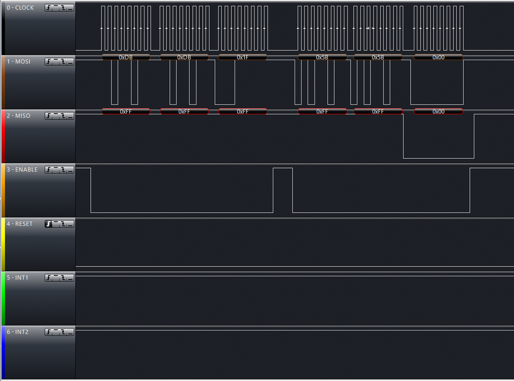

I have reflowed an FXOS8700 to my own development card as an breakout to be able to use it in a project. I am now unsure if it works proper or not.
Is the possibility to read but not write a sign of a burnt FXOS8700 in the reflow process????
SPI setting are CPOL=0 and CPHA=0:
I have no problem to read from an address, but problem to read back what was written.
This is my sequence of SPI commands:

    SPI_WriteFXOS(CTRL_REG1, 0x00);        // Set to standby mode
    SPI_ReadFXOS(CTRL_REG1, rbuf, 1);
    sprintf_P(buffer_0, PSTR("\r\n::CTRL_REG1 = 0x%X\r\n\r\n"), rbuf[0]);
    uart_puts(buffer_0);
    SPI_WriteFXOS(M_CTRL_REG1, 0x1F);    // 200 Hz hybrid mode
    SPI_ReadFXOS(M_CTRL_REG1, rbuf, 1);
    sprintf_P(buffer_0, PSTR("\r\n::M_CTRL_REG1 = 0x%X\r\n\r\n"), rbuf[0]);
=> 0x00
Writing to M_CTRL_REG1 does not work but gives 0x00 back ......

It seems like your both write sequences are not correct. The order of the bits is as follows:
Byte 0: R/W, ADDR[6], ADDR[5], ADDR[4], ADDR[3], ADDR[2], ADDR[1], ADDR[0]
Byte 1: ADDR[7], X, X, X, X, X, X, X
Byte 2: DATA[7], DATA[6], DATA[5], DATA[4], DATA[3], DATA[2], DATA[1], DATA[0]
The first byte you are sending is correct, but the MSB bit of the second byte (ADDR[7]) should be "0" and not "1". So instead of sending 0xDB, 0xDB, 0x1F, try to send 0xDB, 0x00, 0x1F. Then send 0x5B, 0x00, 0x00 to read back 0x1F from the M_CTRL_REG1 register.

Thanks a bizillion times Tomas!
You are my hero and made my day, truly :smileyhappy:
I had used a macro (atmega8) in as if it returned the first bit as set, and it stayed to the second byte ...
Now all three modules work just fine!!!!

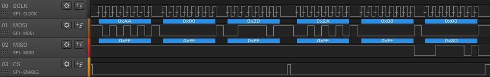

Just for illustration, here is an example of writing/reading the value of 0x3D to/from the CTRL_REG1 (0x2A):
Tomas
