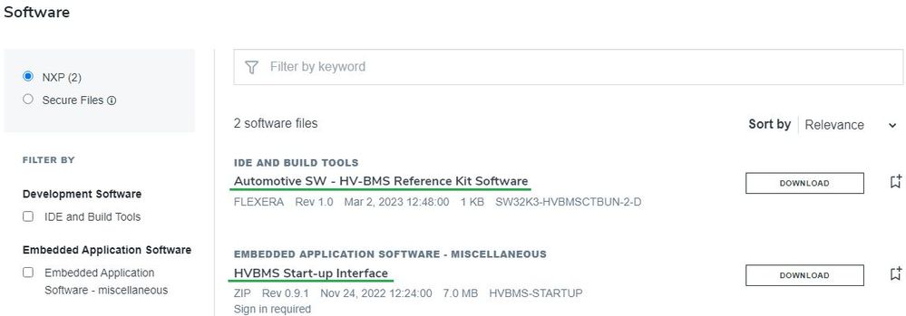

One more question, the HVBMS we received is preflashed with firmware version 0.8.0, so where can I get compatible HVBMS_StartUp_FreeMASTER.elf file?
8,486 Views
TomasVaverka
Hello Shubham,
We strongly recommend to upgrade the FW with the latest .elf file (firmware 0.9.1) and use the latest HVBMS Start-up Interface.
Both can be downloaded from:
https://www.nxp.com/design/designs/hvbms-reference-design-bundle-using-etpl:RD-HVBMSCTBUN
Tomas

TomasVaverka
Hi Shiv,
First of all, please make sure you have all the packages installed in the right order, presented in section 5.1.1 of the HVBMS Installation Guide. This is really important, even some colleagues faced similar problems when they did not follow the order.
There can be multiple reasons for the failure, here is a list:
1. Installation order from the HVBMS installation guide was not followed, BMS SDK was installed first then RTD.
2. Generation timeout of S32DS in order to fix this issue see section : 5.1.1.8.3.1 form the HVBMS installation guide.
“In case of difficulties in the code generation using S32 Configuration due to computer speed, it is possible to remove the timeout in the C:\NXP\S32DS.3.4\eclipse\s32ds.ini file by adding the following line: -Dcom.nxp.swtools.codegenscript.timeout=-1.”
After adding this in .ini file please restart S32DS and create a new workspace where a fresh import has to be tried.
I hope it helps!
Tomas
PS: The HVBMS Installation Guide is classified as a Secure File and can be downloaded from the following website:
