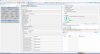

I downloaded the HVBMS RD Bring UP Example.
I imported this project into S32DS.
I opened the .mex file and went to update the code. I received an "Code Generation failed" issue.
When I try to build main.c, it does not build, it is unable to find the files as seen in the output below.
I have the BMS SDK 0.9.0 and the BMS SDK SL 0.9.0 Demo libraries installed.
I also have the S32K3 RTD 2.0.0 installed.
Am I missing something when trying to build this project.
Thank you.

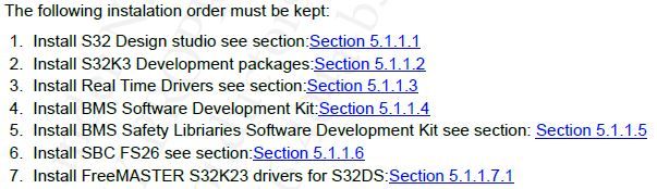

TomasVaverka
Hi Shiv,
First of all, please make sure you have all the packages installed in the right order, presented in section 5.1.1 of the HVBMS Installation Guide. This is really important, even some colleagues faced similar problems when they did not follow the order.
There can be multiple reasons for the failure, here is a list:
1. Installation order from the HVBMS installation guide was not followed, BMS SDK was installed first then RTD.
2. Generation timeout of S32DS in order to fix this issue see section : 5.1.1.8.3.1 form the HVBMS installation guide.
“In case of difficulties in the code generation using S32 Configuration due to computer speed, it is possible to remove the timeout in the C:\NXP\S32DS.3.4\eclipse\s32ds.ini file by adding the following line: -Dcom.nxp.swtools.codegenscript.timeout=-1.”
After adding this in .ini file please restart S32DS and create a new workspace where a fresh import has to be tried.
I hope it helps!
Tomas
