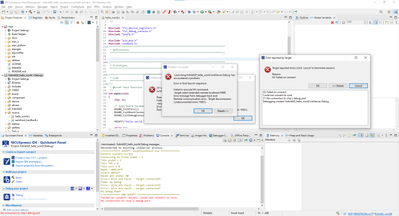

I previously had an NFC card reader demo working on a PN7462AU that was being programmed via an LPC-Link2 debug probe. This demo was running from the package SW3683 (in a folder called PN7462AU_ex_phExMain_mcux under the src folder with the name phExMain_15693.c. that I downloaded off of the NXP website for NFC card reading purposes for this specific board. My colleague was the one who had previously set it up for me. I would simply click on the green debug button and it would work - you would be able to bring an NFC tag close to the antenna and it would write to it then print those bytes to the screen.
However, I unplugged the 2 USBs connected to my PC - the LPC-LINK2 and the PN7462AU (which was just receiving power from the PC) and after moving to a different workstation, I replugged it in. I proceeded to click the green debug icon like I did before. However, right when I did this I was greeted with an error I did not understand (see below).

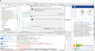

I tried searching up what this failed to execute MI command meant and one response told me that this may have been caused by removing the USB from the PC and causing a debug session to improperly terminate. The solution they proposed was reflashing firmware onto my connected devices. As such, I reflashed the firmware onto LPC-Link2 by running the LPScrypt tool provided by NXP. I believe this worked as the LPC-Linkll was properly identified as a com port on my device. However, when I tried reflashing the firmware on my PN7642AU device by following this tutorial and using the GUI flash tool: https://community.nxp.com/t5/NFC-Knowledge-Base/Program-the-firmware-to-PNEV5180B-board/ta-p/1115153
I was met with the error in this image:
Please note, that I tried to flash several files - not just the default one provided when you press the GUI flash icon but I was presented with the same error regardless.

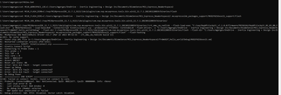

@giraffe508 Thanks for your reply! As a side note, it might have been clear already but I am using the OM27462CDKP evaluation kit. I did a bit of digging and I found this tutorial to let me program the board through the CLI instead of the GUI: https://mcuoneclipse.com/2020/12/05/standalone-and-command-line-programmer-with-mcuxpresso/ I looked into the MCUXpresso manual and I believe the steps outlined in this tutorial and the manual seem to align well. The tutorial told me to preview the command before clicking run on the GUI flash tool, take this command and save it in a .bat file which can then be run via the command prompt on Windows. I tried doing this on both laptops (the one with the existing setup and the other with the new setup I was trying to configure). After doing this, I was met with the same errors. This is the error I found on the new laptop - the one on which I was trying to create a fresh setup:

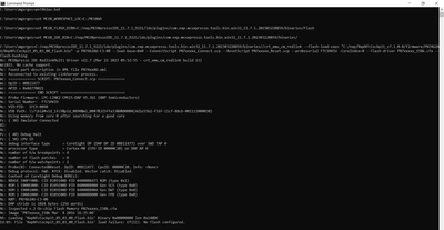

This is the error I got on the old laptop (the one that was previously running the existing setup):

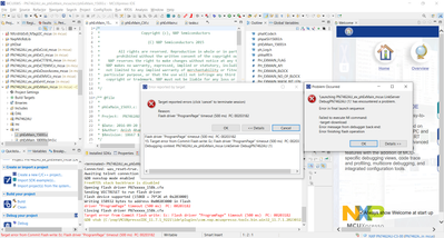

which practically matches the error I received from the GUI earlier on:
I was wondering if the file I was using could have been the source of the error. I got the firmware of the file from the directory: C:\nxp\NxpNfcCockpit_v7.1.0.0\firmware\PN7462AU\NxpNfcCockpit_05_03_00_Flash.bin. I believe this file came into my computer after downloading the nxp software (which creates an nxp directory on my C drive). However, I did notice that the NFC cockpit's version in v7.1.0.0 while the flash file's version is 5.3.0.0 (from its name). Could this be an issue, I remember reading somewhere that the NFC cockpit and the board need to have the same version so that the Cockpit could recognize the board?
