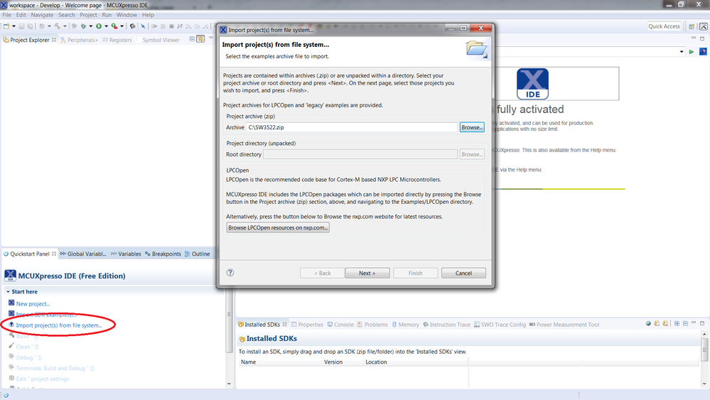

4. Start MCUXpresso IDE and import any LPC1769 project from filesystem. For example: SW3522.zip. This is important to give programmer right definitions.
SW3522 can be downloaded from here : NFC Reader Library v4.040.05.011646 R1 for PNEV5180B including all software examples

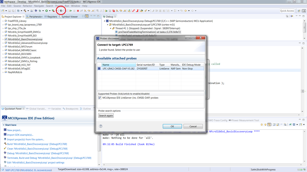

Click LinkServer GUI Flash programmer icon on the main menu. When started programmer tool will check if LPC-Link2 debug probe is attached.

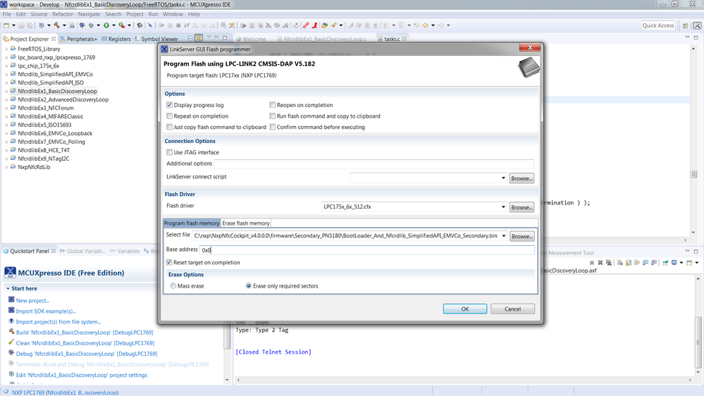

6. Browse to the C:\nxp\NxpNfcCockpit_v4.0.0.0\firmware\Secondary_PN5180\BootLoader_And_Nfcrdlib_SimplifiedAPI_EMVCo_Secondary.bin.
Set the Base address to 0x0.

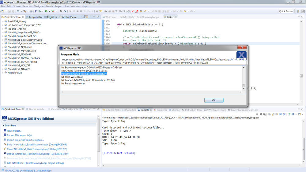

7. Flash Write Done.

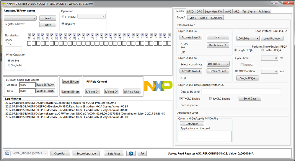

8. After this, reset the board and to start NFCCockpit v4.0.0.0. The board will be recognized.

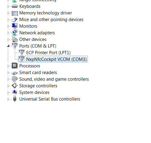

P.S. The board is connected to PC via VCOM. If there is any driver issue, please try to re-install the VCOM driver and restart the PC. The VCOM driver can be found in the C:\nxp\NxpNfcCockpit_v4.0.0.0\VCOM.
