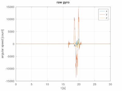

Raw Data (Acc sensitivity=0.488mg/LSB, gyro sensitivity=17.5mdps/LSB)
Raw accelerometerRaw accelerometerRaw gyroscopeRaw gyroscope
The raw accelerometer data is easily validated, the gravity is visible on the Z with 2070 counts. 2070*0.488=1010mg.

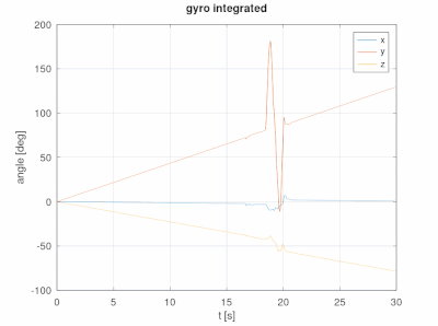

To validate the gyroscope data I integrated it (outside the fusion library) obtaining this:
Integrated raw gyroscopeIntegrated raw gyroscope
Apart from the drift due to the gyro offset (which was expected given that no correction is applied on the raw data), the 90° clockwise - 180° anticlockwise - 90° clockwise rotation pattern on Y axis is clearly visible, therefore the sensor iteself looks ok.

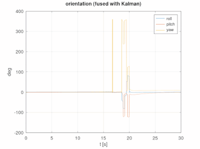

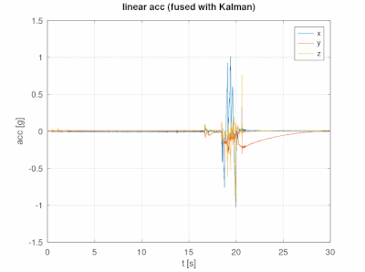

However, when the raw data is fed into SV_6DOF_GY_KALMAN algorithm, the resulting linear acceleration and orientation angles are:
Linear accelerationLinear accelerationOrientation (roll/pitch/yaw)Orientation (roll/pitch/yaw)
Here I see something different than what I expected. First of all the Y axis of the acceleration, after the stimulus, takes a while to return to 0. The orientation instad have strong and unexpected discontinuities that I cannot explain.
So, is there someone that can suggest what I might be doing wrong or where to start the debug?
