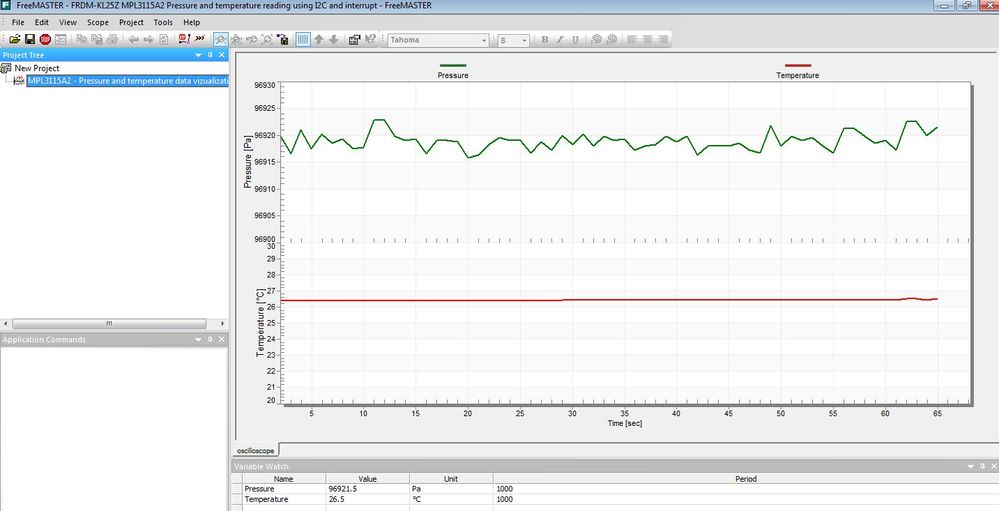

I'd like help selection an air pressure sensor chip for a new product. I'll give a summary of our requirements here:
- Size: Not critical, but we're looking for a PCB-mount chip to measure the air pressure at the chip.
- Pressure range: Normal ambient pressures at normal ground altitudes.
- Operating temperature range: Preferably at least 0-60 Celsius.
- Interface: For design simplicity, an I2C or SPI interface would be highly desirable.
- Sample rate: We need accurate data at about 10Hz, so allowing for noise I expect we need about 100Hz or higher.
- Voltage: Preferably 3.3V, but we can probably design around 1.8V or 5V.
- Power: Fairly important, preferably in the Milliampere range, but we can make allowances for more power if necessary.
- Cost: Around a couple of dollars per chip.
- Accuracy: This is critical. We do not need absolute accuracy or temperature stability, but we need to accurately measure pressure differences over a period of seconds with a resolution of 1Pa (0.001 kPa). We're well aware that this will be beyond the specifications of any chip we choose, but I believe that over a period of seconds with no need for temperature stability or stability over longer periods of time, and appropriately filtering the data to remove noise, we should be able to achieve a 1Pa resolution for measuring pressure difference at about a 10Hz rate.

Hello Jeff,
Thank you for your interest in NXP pressure sensors.
Based on your requirements, I would recommend considering the MPL3115A2.
- Size: 3 x 5 x 1.25mm 8-pin LGA package
- Calibrated pressure range: 50kPa to 110kPa absolute pressure
- Operating temperature range: −40°C to +85°C
- Interface: I2C only
- Sample rate: Depending on OS[2:0] bits, more in Table 46 of MPL3115 datasheet
- Voltage: 3.3V is OK (1.95V – 3.6V)
- Power: Depending on OS[2:0] bits, more in Table 6 of MPL3115 datasheet, the max current during acquisition and conversion is 2mA
- Cost: 1K @ US$1.69
- Accuracy/Resolution: Depending on OS[2:0] bits, theoretically 1.5Pa @ max OS[2:0] = 0b111, a quick test on my desk:
To evaluate the MPL3115A2, we can offer a complete demo kit, an Arduino/Freedom compatible shield board or just a breakout board - MPL3115A2 Pressure Sensor Development Boards|NXP.
If you have any further questions, please let me know.
Tomas

Hi Tomas,
Thanks for your help. I'll order a couple, attach it to our current
prototype, and see how it performs. Based on the datasheet it looks like
the accuracy may only just manage to fit our requirements - a bit faster
and a bit more accurate would be better - but there's a good chance that in
real-world conditions we'll have more problems with accuracy due to the
housing (porting, vibration) than due to the sensor. We'll soon find out!
