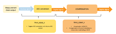

 Getting a sensor value with the accuracy specified in the datasheet is done in two steps:
1. The function TPMS_READ_xxx is executed. This function returns a raw value which is the output of the ADC. This value is
not completely linear and for pressure and acceleration it also includes an error due to the sensor deviation with
temperature and voltage.
2. The function TPMS_COMP_xxx is executed. This function takes the raw measurement as input and returns a
compensated value which has been linearized and, for pressure and acceleration, corrected of the sensor deviations with
temperature and voltage. It is this compensated measurement which is specified in the datasheet.
So, yes, you can TPMS_READ_xxx value.
Please note that for the pressure sensor and accelerometers are sensitive to voltage and temperature, the compensation function will correct the error due to the voltage and temperature sensitivities. This is why the compensation function needs the voltage and temperature values as input.
Hope this helps!
