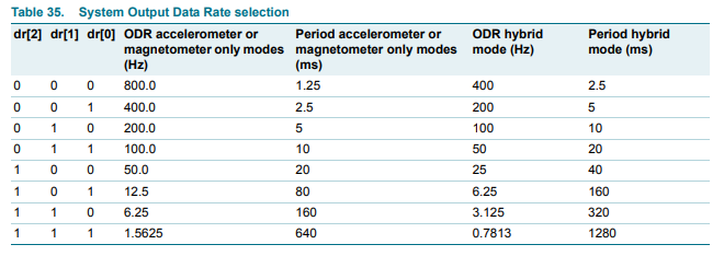

In hybrid mode with both sensors active, the ODR is identical for both the accel and mag and can be set using dr[2:0] bits of the CTRL_REG1 register according to Table 35.

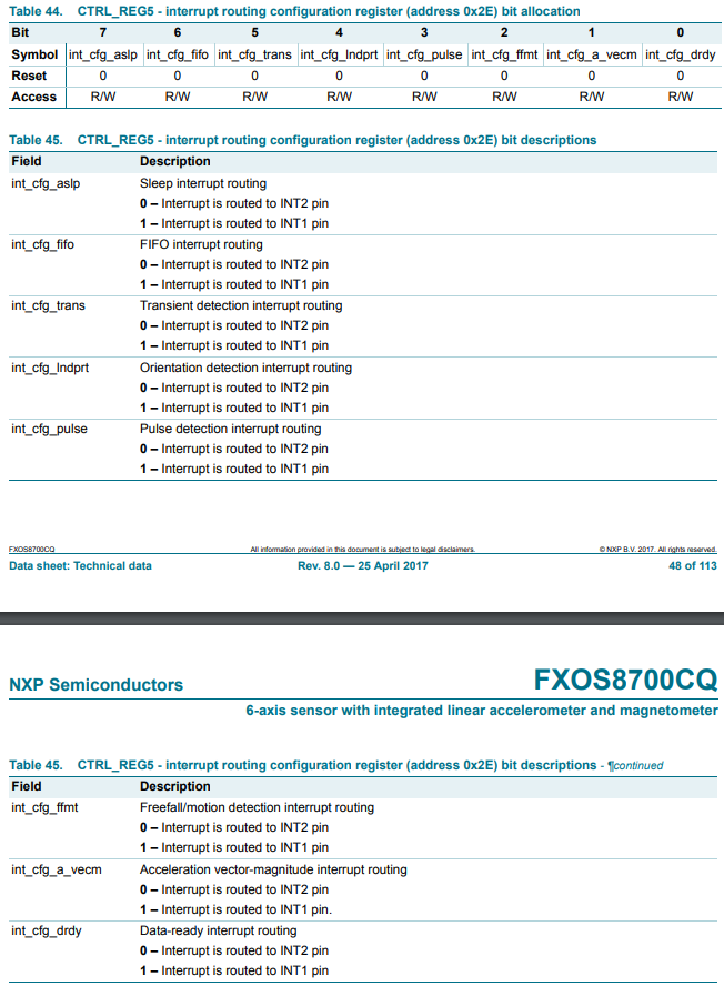

Routing to either INT1 or INT2 pin is done using bits in the CTRL_REG5 register.
