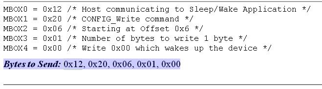

Thank you David for your quick response. I did send 0x00 0x00 0x00 0x0c to MMA9555L and receiving proper versions from it. But on sending 0x12 0x20 0x06 0x01 0x00 I am not receiving any valid data and instead receiving 0x00 0x80 0x0c 0x0c 0x7a 0xed as responce from it instead of receiving Accelerometer data. Also tried sending

david_diaz
Hello Prasanna,
I am glad to help.
Please be aware that the device powers up in Sleep mode, but it may become necessary to wake the part. This process uses the following mailboxes:

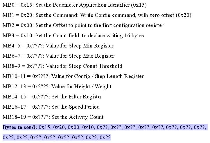

Once the device is awake, you may proceed with the pedometer application configuration as follow:
You may read the status registers properly.
Please let me know if this information is useful for you.

Also for the commands you shared, Post sending
aTxBuffer[0] = 0x15;
  aTxBuffer[1] = 0x20;
  aTxBuffer[2] = 0x00;
  aTxBuffer[3] = 0x10;
  aTxBuffer[4] = 0x00;
  aTxBuffer[5] = 0x10;
  aTxBuffer[6] = 0x00;
  aTxBuffer[7] = 0x10;
  aTxBuffer[8] = 0x00;
  aTxBuffer[9] = 0x00;
  aTxBuffer[10] = 0x00;
  aTxBuffer[11] = 0x00;
  aTxBuffer[12] = 0x00;
  aTxBuffer[13] = 0x00;
  aTxBuffer[14] = 0x00;
  aTxBuffer[15] = 0x00;
  aTxBuffer[16] = 0x00;
  aTxBuffer[17] = 0x06;
  aTxBuffer[18] = 0x00;
  aTxBuffer[19] = 0x10;
  MMA955L_AcclDataTx(aTxBuffer, 20,0x15); //Send 20 bytes command to configure pedometer
//read status reg:
  aTxBuffer[1] = 0x30;
  aTxBuffer[3] = 0x0c;
and reading 16 bytes of data response I am receiving is 0x15, 0x30 ,0x0 ,0xc, 0x0 ,0x10,0x0,0x10,0x00,0x00,0x00,0x00,0x80,0xc,0xc,0x7a
Is that valid?  As per data sheet 2 byte should be 0x80 but I am receiving 0x30. Is something wrong in sending ?
Prasanna
