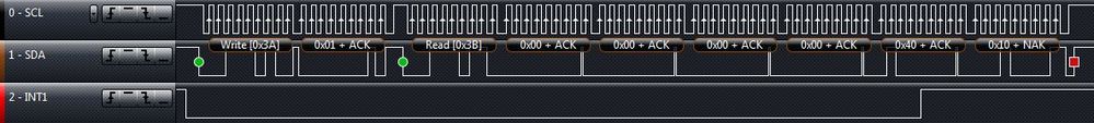

OK thank you  for your fast reply.  I am converting the code for another MCU.  Can you explain the below command.  I have outlined what I think is happening, is this correct?
* MMA8652FC_I2C_ADDRESS = I2C address.
* OUT_X_MSB_REG = register.
* AccelData = int16_t AccelData[8];
* Is the 6 in the I2C_ReadMultiRegisters() just reading the low 6 bits?
* If the above is correct, therefore my command is wrong as I am reading the whole word, read_word(MMA8652FC_I2C_ADDRESS, OUT_X_MSB, AccelData);

TomasVaverka
I do not quite understand your question.
I believe it is obvious that the burst read is performed using the I2C_ReadMultiRegisters(MMA8652FC_I2C_ADDRESS, OUT_X_MSB_REG, 6, AccelData) function, given the 7-bit slave address of the chip (0x1D), the address of the first register to read (0x01), the number of bytes to read (a value of 6 reads all six data output registers 0x01 – 0x06) and the name of an array of six bytes to store the data in. Such a burst read of 6 bytes from registers 0x01 to 0x06 looks like this:
Hope it is clearer now.

TomasVaverka
It is usually hard to say whether the function is correct or not without seeing what is going on the bus. Do you have a logic analyzer or an oscilloscope to see the traffic on the bus?
Both the single and multiple bytes read transactions are described in the MMA8652FC data sheet (chapters 5.11.1 and 5.11.2). In my source code, you can find the I2C routines in the I2C.c file within the Sources folder.
