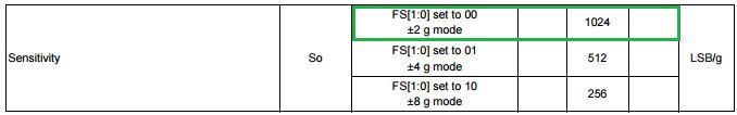

I am just working through the MMA8652 example code, and generating my define values.
After searching the net I cannot find an example define value for the  SENSITIVITY_2G.  So would the below be correct for the example code?
#define SENSITIVITY_2G    1024
Z_offset = (Zout_12_bit - SENSITIVITY_2G) / 2 * (-1);          // Compute Z-axis offset correction value

Yes, it is correct:
// MMA8652FC Sensitivity
#define SENSITIVITY_4G  512
#define SENSITIVITY_8G  256
