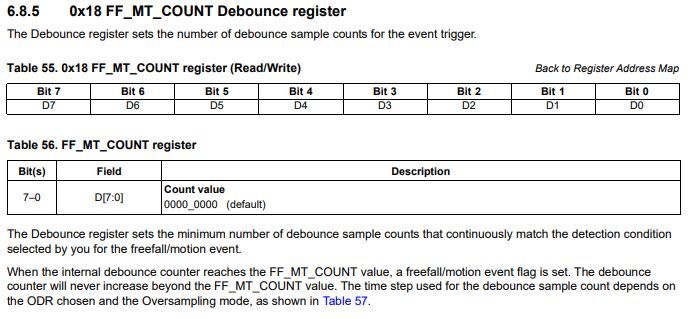

Some weeks ago I bought a develpment board with the mma8652 accelerometer. I want to implement a counter of motion events with the register FF_MT_COUNTER. For any reason, I can't read a different value than 0 and I don't know why. I left you my configuration registers.
F_SETUP= 0x80h
FF_MT_CFG=0xF8h
FF_MT_THS=0x85h
Toni

Hi Toni,
There seems to be some misunderstanding. The FF_MT_COUNTER register does not count motion events. Using this FF_MT_COUNTER register you can set the debounce filtering time to filter out irregular or spurious events.

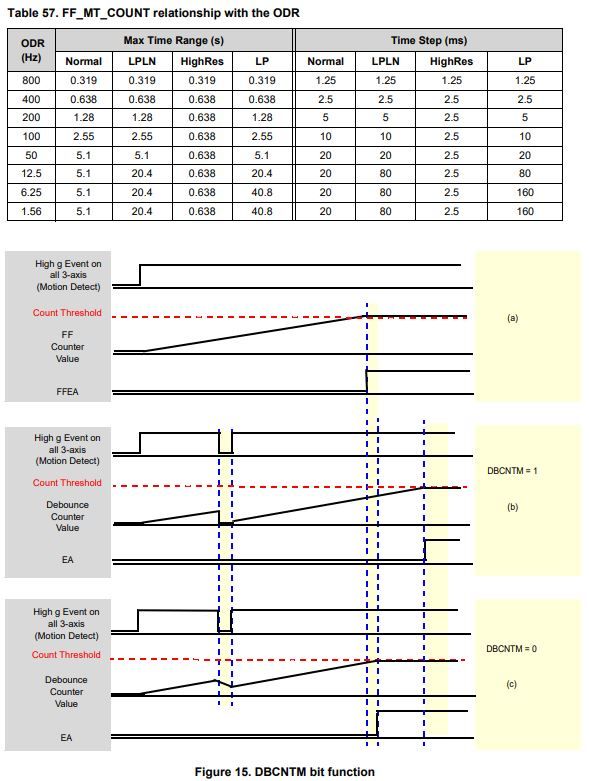

Note that the time step used for the debounce sample count depends on the ODR and oversampling mode (Normal, LPLN, HighRes, LP). For example, an ODR of 100Hz in Normal mode and an FF_MT_COUNT value of 10 would result in a minimum debounce response time of 100ms (10ms x 10 counts).
Tomas
