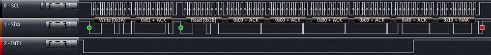

The SRC_DRDY bit is cleared and consequently the INT1 pin deasserted by reading all the X, Y, Z output data registers (0x01 – 0x06) as shown in the picture below.
If you are having problems to implement a multiple bytes read function, you can try to read these registers separately using a single byte read function which seems to be working if you can read the WHO_AM_I reg.

I have tried reading the X, Y, Z output data registers (0x01 – 0x06) with multi_byte_read, and single_byte_read to clear the interrupt but my I/O pin stays low and the interrupt is not cleared.

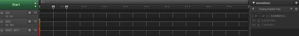

Since you are using the DRDY interrupt, an interrupt event occurs when a new set of acceleration data has been generated and is available to be read (each 0.64s @ 1.56Hz ODR):
However, based on your description, you should use either the motion or transient functions to generate an interrupt when the acceleration exceeds a set threshold. Please take a closer look at our AN4070 and AN4071 for more information and example settings.
