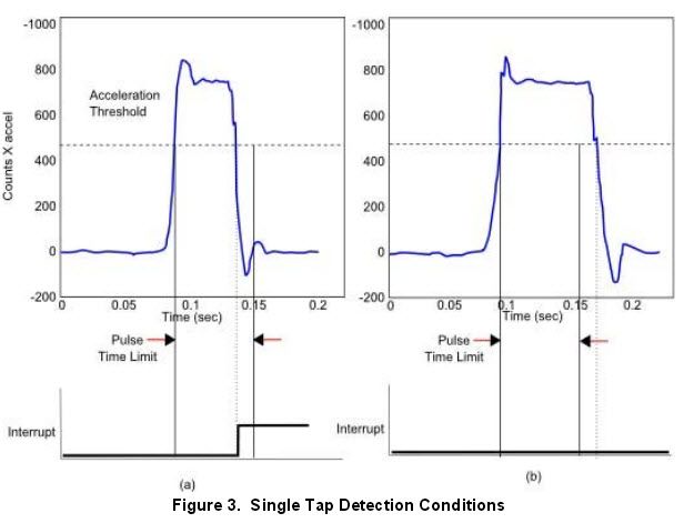

The Motion is often used to simply alert the main processor that the device is currently in use. When the acceleration exceeds a set threshold, the motion interrupt is asserted. On the other hand, the Tap detection function has various customizing timers, for setting the pulse time width and the latency time between pulses.
As a summary, Motion detection detects a threshold and Tap detection detects pulses.

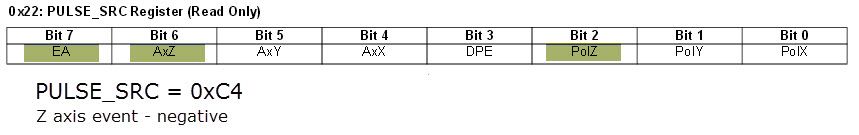

By reading PULSE_SRC (0x22), will it show me which side of the IC or board I am tapping? Is tapping at the bottom side mean negative pulse in z-axis?  Will it set bit 2 to 1? As I don’t always get consistent value when I tap at the bottom side.
I just want to disregard a pulse (negative?) caused by a tapping the table or something which my board is place. I want only a tap coming from the  top or direct hit/shock.

Indeed, the PULSE_SRC register indicates a double or single pulse event has occurred and also which direction.
By reading the register mentioned, you can configure your application in case you want to disregard the Z-axis positive/negative direction.
For example, if you tap the device in the Z-axis and negative direction, you will read the PULSE_SRC register as follow:
In this case, I would like to recommend a sample project that could be useful for you in order to read the PULSE_SRC register.
Please find the sample project at MMA8451Q -Single Tap Detection Bare metal example project .

When tapping at the negative side, I sometimes read PULSE_SCR = 0xC4 or 0xC0. Does this value depends on how strong i tap?

For a single tap event there are three key parameters to consider.
  1. Time Window for the tap signature to cross a threshold and drop below it (PULSE_TMLT)
  2. Threshold Value to Trigger the event (PULSE_THSX, PULSE_THSY, PULSE_THSZ)
  3. Latency time to hold the event conditions (PULSE_LTCY)
In this case, you may modify the pulse Z threshold register in order to define the threshold used by the system.
