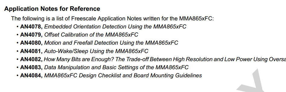

MMA8563 chips were used to detect the car collision events in my system.Questions as follows:
1. the rate of false positives is higher,
2. do you have this aspect of the application or algorithm,Or do you have any Suggestions,
3. We can only download AN4083 document,other documents can't download, if you can provide?

To get more information on the functions described in the app notes you can find the same information in reference to the MMA8452QR1 device.  The features are very similar between the devices so you can use this as reference material.
Here's the link:
±2g/±4g/±8g, Low g, 12-bit Dig|Freescale

Regarding car collision events detection refer mainly to High-Pass Filtered Data and Transient Detection app. note no. AN4071. This one as well as the others are for the MMA845x family but do apply for the MMA856x family as well.
AN4071: http://cache.freescale.com/files/sensors/doc/app_note/AN4071.pdf?fasp=1&WT_TYPE=Application%20Notes&...
Other app. notes from the list but with different numbers can be found at following link:
±2g/±4g/±8g, Low g, 10-bit Dig|Freescale
As I have mentions the content of the app. notes applies for MMA8563  as well.
