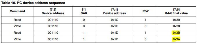

I'm trying to get an MMA8452 working with a small 8-bit micro (8051 based). I'm bit-banging the I2C interface but the MMA8452 never responds. Looking at the scope, the comms frequency is about 60 kHz which the sensor should support.
Whenver I send the address (0x1D), I never get an ACK. If I ignore this and attempt to get a reading (e.g. from WHO_AM_I register) I always get 0xFF back meaning the device does not respond. I can scope the I2C lines and they look OK.
The procedure I'm using is (complete c file is attached).
// Start
      I2C_START();
    // Slave address
  I2C_WRITE(0x1D);
    // Slave control byte
  I2C_WRITE(0x0D);
     // Start
  I2C_START();
    // Slave address + read
  I2C_WRITE(TARGET | 0x80);
    // Read
    inData = I2C_READ();
VDD and VDDIO are definitely connected to 3V. Is there anything wrong with this? I really need an answer quickly so please respond as soon as you are able. If there is anything else you need to know, then please ask.

Hi Adam,
Looking at your source code, it seems that you are not using the correct I2C slave address. Considering SA0 = 1, the 7-bit slave address is 0x1D, which translates to 0x3A for a write and 0x3B for a read:
To read e.g. the WHO_AM_I register (0x0D) you have to:
1. Send a start sequence
2. Send 0x3A    // MMA8452Q slave address with the R/W bit low or 0x1D<<1
3. Send 0x0D
4. Send a start sequence again (repeated start)
5. Send 0x3B    // MMA8452Q slave address with the R/W bit high or (0x1D<<1)|0x01
6. Read the data byte from the WHO_AM_I register
7. Send NAK and a stop sequence.

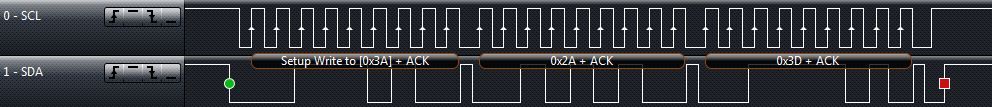

Below is the image from a logic analyzer illustrating it (note that it is for the MMA8652FC I have on my desk).
And here is a single byte write operation which writes the value 0x3D to the CTRL_REG1 register 0x2A.
I hope it helps.
