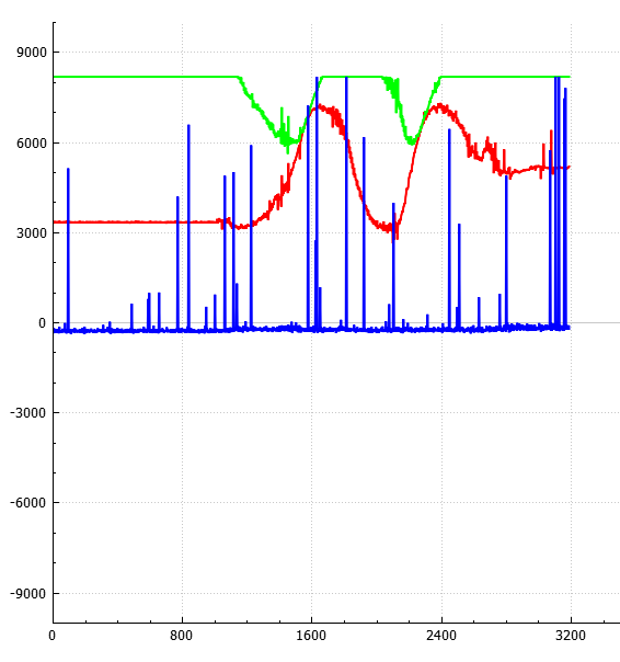

We at my company, has a very strange issue regarding til MMA8451. We are experincing that our accelerometers data can be suddenly wrong over time.
We have approximately 250 devices out, running in the field, and we have about 10 devices which got this problem. What happens is that the sensor data:
 - Suddenly has a completely wrong offset (out of the min/max values, that the MMA should even be capable of).
 - Or has it's z-axis locked in a "fixed" value or fluctuating.
We see that a mechanical bump of the PCB/sensor can make it suddenly work again. That makes us think that the MMA chip has been damaged.
If we take a brand new MMA and solder onto a PCB which had the problem ealier, no problems exists. So it's happening over time. And when it has happend, it can recover or come back to normal again.
We do of course have a lot of software, checking that all communication is alright on the I2C etc. We interface with a STM32 microcontroller. When the problem occurs, all power offs, resetting the chip etc, has no influence of the wrong data.

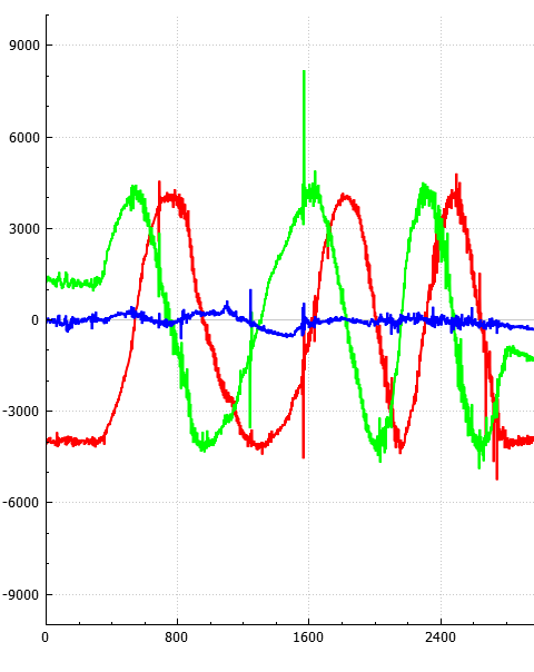

Here I have some visualizations of how the data looks. First an all normal functioning MMA measurement: (x-axis = red, y-axis = green and z-axis = blue). All measurement are done with the device fixed horizontal in the z direction, and then turned around the z-axis.
The x axis of this graph is samples (100 hz sample rate). The y axis is the raw sensor value.
The following pictures shows malfunctioning MMA measurements:
And another:
As you see, the sensor works in some sense, as the x and y axis changes. But has an unrealistic offset. If we hit the device mechanically, the axis happens to be normal afterwards.
The z-axis can act like this, just fluctuating, or it can be locked in either 8192 (max) or -8191 (min).
We have done various ESD tests to debunk that hypothesis. But we are very confused.

It sounds to me partially like a quality problem known as Z-axis stiction failure. Devices with this failure usually have a positive (0x7FFC) or negative (0x8000) railed output.
In fact, sticking can arise during manufacturing or in the use of the device. As you can see in the the PCN14989 and PCN15484, there have been made some design/test improvements to eliminate this failure. In‐use sticking may occur after a high acceleration event causes its movable elements to contact its fixed surfaces. Another mechanical shock usually bring them back to work properly.
Customers that experience an issue similar to this can contact our quality team and customer service team. The NXP Quality team will enter the information into the NXP CQC system to route to the correct quality team and business line contacts for support.
As for the offset on the X (red) and Y-axis (green), I have not heard or seen similar problems so far. I would recommend to send back the affected pieces to perform a quality analysis. Our standard procedure for this is to submit a CQI request for failed parts through your purchasing party.
